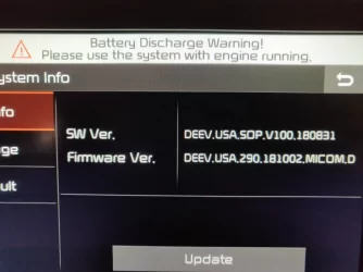

It would be great if KIA was willing to fix their crappy software but I'm not holding my breath. They have not released a single update since the car was released beyond just simple nav/maps for the infotainment system. When I asked my dealer to pass these issues along they just told me to file a complaint via the website (which I did last May).

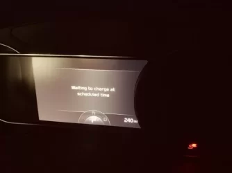

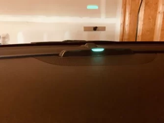

The 3 minute thing is just the time the car always takes to fall asleep. It will blink the green LED during that time to tell you that charging has been delayed and you have 3 minutes to override it with the button inside the car. At no point in this process is it actually measuring your EVSE true charging speed capability.
