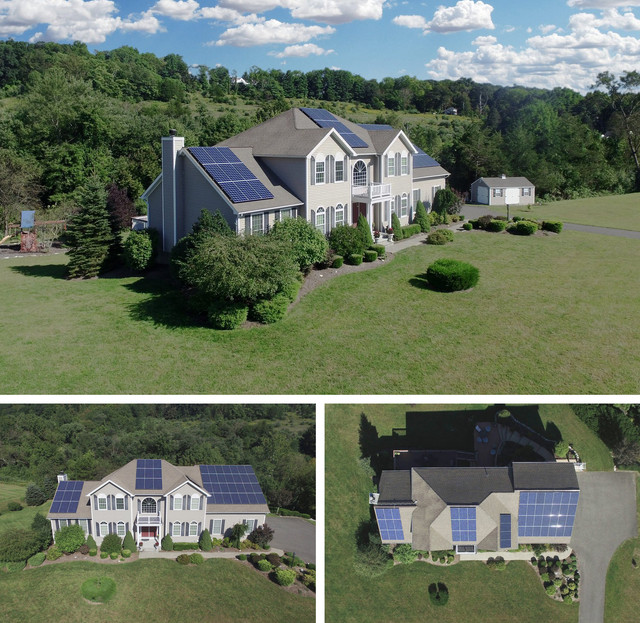

Winter is when we consume more than we generate - heat pumps, short days, and it seems like lots of clouds. We are in coastal DE and our array is 9.75kW. I wish I could take credit for the thing - when we bought the house it already had the solar on it.
We have propane, but it is only used for a largely decorative fireplace (it does throw some amount of heat, so it isn't totally useless).
