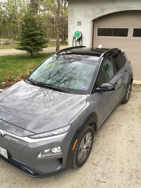

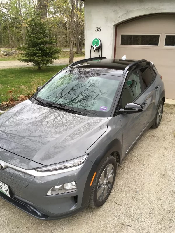

Just got a Kona Electric SEL here in Maine. There was no option at any trim level for the factory roof side bars. Even though all other countries seem to get roof side bars. And so do the gas versions.
Has anyone purchased the roof side bar parts for a gas Kona and attached them to an electric?
To me, it looks like I'd have to drop the headliner and drill studs up from inside, then seal with 3M 5200 or something.

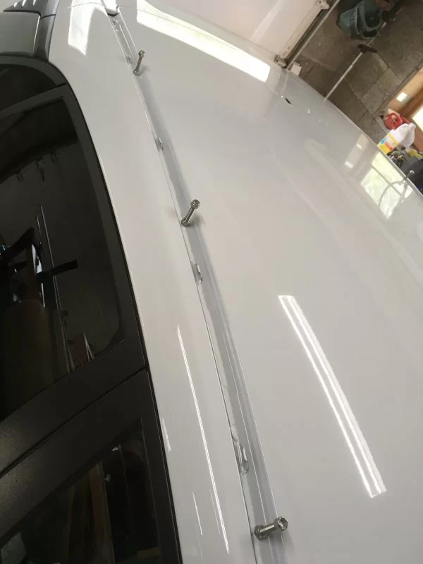

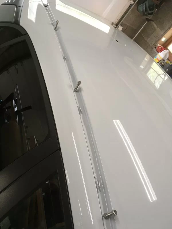

Ordered roof rail parts:
87270-J9000-PGY LH roof side rail
87280-J9000-PGY RH roof side rail
87293-J9000-PGY CAP (qty 6)
They arrived the other day.
Dropped head liner. Laid roof rails in place with front edge 5 3/16" from top of windshield glass. Verified mounting holes are clear on the inside. They are. Started drilling with my new 1/8" super-duper cobalt nitride titanium bit. And kept drilling. And kept drilling. No dice. Grabbed a 5/32" carbide masonry bit that came in a box of concrete screws. Used a diamond sharpening stone to get a decent edge on the carbide. That did the trick. Six holes lickety split. Used a step drill to open em up to 5/16". The bottom of the gutter is too thick for the step drill to go all the way thru so chased it with a 5/16" twist bit. The bit was wrecked after reaming 4 holes. Grabbed another bit for the last two.
Had my son inside the car with a box wrench while I locked down stainless steel aircraft nuts to 5/16"x2" SS hex head bolts. There's a SS washer in the inside. Put a blob of silicone plus under the nut and went full tight.
Then I'm going to fully embed the nut in silicone. I'll drill holes in the gutter trim piece and bolt the side rails on with a second SS washer and aircraft nut.
