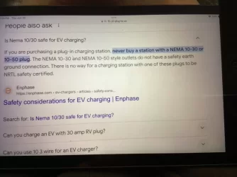

If I read this I will stay away from 10-30 plug
NEMA 10 sounds unsafe, especially as a way to charge EVs since it relies on grounding of the frame: As commonly used, 10-30 and 10-50 plugs required the frame of the appliance to be indirectly grounded via a strap connecting to the neutral blade.
I can't imagine grounding an EV sitting on rubber tires is really going to work.

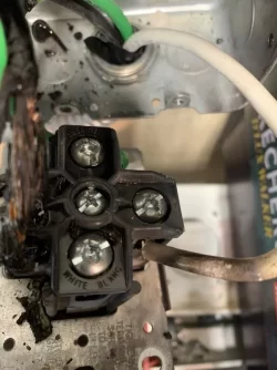

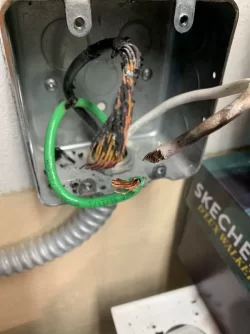

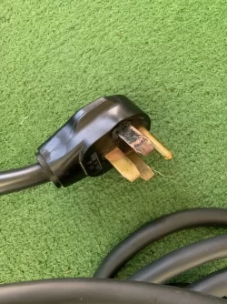

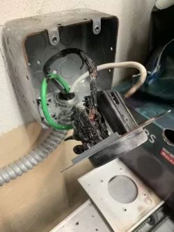

NEMA 14-50 240 Volts with 40 amps double breaker

Thats a poorly designed outlet problem, or say an outlet designed for a low duty cycle and few insertion type household use (dryer welder). Its a common problem with the Leviton dryer/welder type outlets you find all over. There have been fires.
A little more expensive, harder to find on the store shelf, so called HD outlets don't have that problem. Its been talked about here now and then I think.
I replaced my original Leviton with an HD type and have seen no issues. The Leviton looked pristine too, but I rarely unplug the charger.
