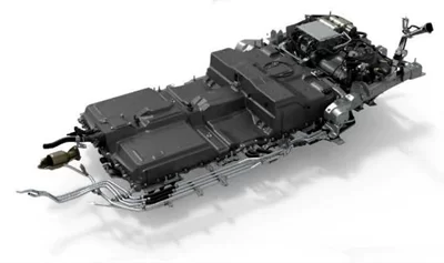

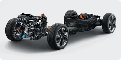

Did you see the Underbody Photos thread? It shows what the underside of the Clarity PHEV looks like after removing the aerodynamic panels.
Here are photos of the battery with and without engine and wheels. You can see there are batteries under both front seats and under the rear seats, too.
Looks like the batteries are well above the frame of the chassis. I think the cross beams on the chassis/frame would prevent most anything from making it to the area where the batteries are mounted. Here's an explanation of the Clarity's structual design. The Clarity’s lightweight, clean-sheet chassis, designed specifically for electrified applications (yes, that includes the hydrogen fuel-cell version), shows Honda's usual, obsessive attention to engineering detail. It includes aluminum subframes and a largely aluminum suspension front and rear; big doses of super high-tensile steel; and the industry’s first resin-molded composite rear bumper that meets all crash standards.

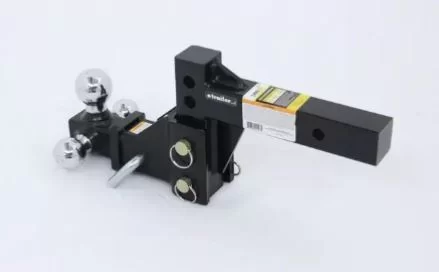

To be fair to Tesla's that 2013 Model S that caught on fire hit a three arm trailer ball mount that had fallen out of some trucks receiver, sounds like it had a drop on it also. Those things weigh over 20 pounds and when on the ground one part is always sticking up over 8 inches. They are like a land mine, hence the pin with cotter key that should have been used to keep this from happening. Those things would rip the bottom of any sedan to shreds. Wouldn't it be nice to have them stamped with a serial # to trace back to the owner.
