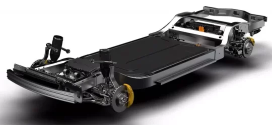

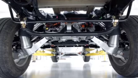

One problem with using in-wheel motors or axle motors is that limits the motor to running at exactly the same RPM speed as the wheels. Generally speaking, electric motors work more efficiently and more smoothly when they are run at higher speed, which is why most EVs have the electric motor connected to the drivetrain with a reduction gearset, to allow the motor to run at a higher speed than the wheels.
Electric motors which run at the (relatively) slow speed of the wheels also have problems with cogging:
If the R1T (I mistakenly called it the "RT1" above) and the R1S have 4 smaller inboard motors, then does each have a separate reduction gearset to avoid the various problems of limiting an electric motor to running at the same RPM speed as the wheels? Or does Rivian accept all the problems and limitations of slaving the speed of the motors to that of the wheels?
Either way, the problems associated with using 4 separate motors are going to drive up the complexity and cost of the vehicle, and possibly or even probably make it more prone to mechanical breakdown.
As I've implied, I won't be at all surprised if Rivian switches to two inboard electric motors for the production vehicle.
Cogging torque of electrical motors is the [torque] due to the interaction between the permanent magnets of the rotor and the stator slots of a Permanent Magnet (PM) machine... Cogging torque is an undesirable component for the operation of such a motor. It is especially prominent at lower speeds, with the symptom of jerkiness [when used to propel a vehicle, rather than smooth forward motion]. -- Wikipedia
