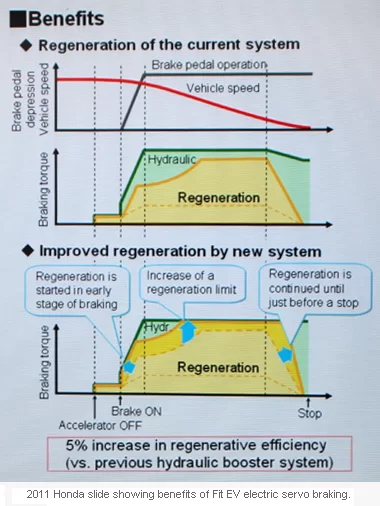

I think the chart on this page (although talking about the Fit EV), helps explain a little bit of the concept of sharing brake torque with the brakes:
https://www.plugincars.com/honda-reinvents-regenerative-braking-fit-ev-110596.html
Lets also keep in mind that the regen braking operates only on the front wheels, and presumably some torque is applied to the rear brakes when the brake pedal is used, compared to the regen paddles which (one would assume) do not act upon the rear brakes at all.

Very interesting. The Honda slide showing benefits of new electric servo braking clearly illustrates that regen braking happens before friction braking. However, it's not simply regen braking first followed by friction braking because this slide shows that friction braking occurs both early and late in the process of stopping the car.
I didn't realize there were so many different corporate philosophies about how brakes should feel. The article says that BMW wants regen braking to be aggressive, while Ford wants braking to feel just like a conventional car--isn't that also Honda's philosophy and what Honda has accomplished with the Clarity? It seems Honda's Mr. Hatano is saying that in the article and it's unclear how the Fit EV's braking is more like that of the Nissan Leaf than the Ford Focus Electric:
