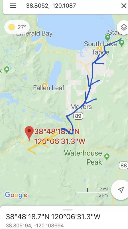

The attach map shows when the video is taken. The blue line is uphill and orange is the downhill. It could not have been more than 5 miles of downhill . I pretty much noticed right away since it didn’t provide the expected resistance. I tried to change all different setting before taking the video.
If overheat is reason, is it possible that the uphill climb where HV mode used generated heat? It was quite a steep hill.

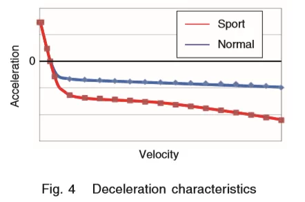

You may be able to reclaim more regen in SPORT mode, assuming you were in ECON or NORMAL modes.
This regen deceleration graph was for another Honda car, but employing the similar iMMD drivetrain.
