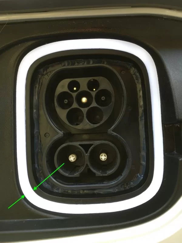

Sealed the ring where your 2 bottom arrows are shown both sides but still have to do the back,I cleaned around the LED with soapy water and iso alcohol and let dry. I then laid a small bead roughly around the ring at the edges with the black plastic, see the arrows. I then forced the RTV into the tiny gaps with my thumb. Lastly, wiped off all RTV left on the surface with a wet rag. I then also ran a bead at the back as you can see. It's not pretty and almost certainly not needed but I felt it couldn't hurt. That's the interface between the socket that's attached to the car and the front bumper which includes the LED, the door and latch. If the bumper was removed this RTV would tear apart.
thought I had enough but of course I ran out of sealant.
