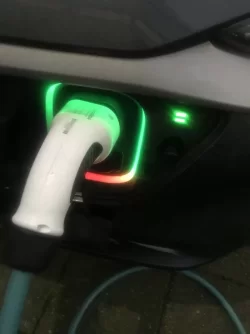

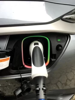

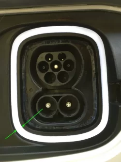

I cleaned around the LED with soapy water and iso alcohol and let dry. I then laid a small bead roughly around the ring at the edges with the black plastic, see the arrows. I then forced the RTV into the tiny gaps with my thumb. Lastly, wiped off all RTV left on the surface with a wet rag. I then also ran a bead at the back as you can see. It's not pretty and almost certainly not needed but I felt it couldn't hurt. That's the interface between the socket that's attached to the car and the front bumper which includes the LED, the door and latch. If the bumper was removed this RTV would tear apart.
Sealed the ring where your 2 bottom arrows are shown both sides but still have to do the back,
thought I had enough but of course I ran out of sealant.:oops:

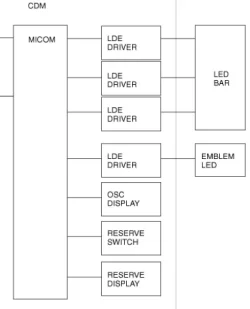

You know, if the electronics inside are not working correctly due to trapped moisture, this might have something to do with your difficulties sometimes with removing the charge plug. I still recommend taking it to the dealer.
I checked the relevant wiring diagrams and I'd have to say that looks unlikely. The two functions seem to have no wiring in common and are mounted on different parts of the front end. The LED, timer override button and door sensor are all CAN controlled as one assembly while the lock actuator is wired directly to relays.
