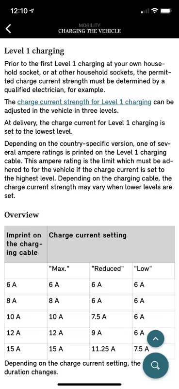

the three amperage options are something like low, reduced and maximum. I cannot find anywhere these generic levels corresponding to the available amperage of the house socket. Anybody find a rule of thumb on this?

According to the owner's manual, it depends on the maximum ampere rating of the Level 1 charging cable delivered with your SE:
No idea how it relates to Level 2 charging, as that isn't covered in the manual as far as I can tell.

And, also, the amperage of the socket and associated breaker/circuit.
A "regular" 15A house socket should not exceed 80% (12A) for continuous use, so if that's what is in one's garage, the car's setting should be set to a max of 12A, regardless of the connector's capacity.
If one's garage has 20A sockets (and, presumably, breakers), then one could set the car's draw at a maximum of 16A and be OK.
