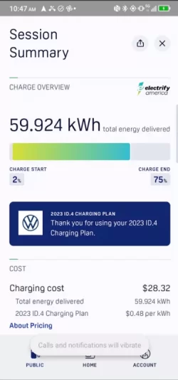

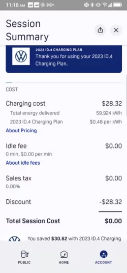

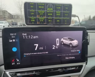

My ID 2023 awd Pro S with SK battery typically pulls over 180kW and 80kW at around 80%
I was @ 2% yesterday took 30 minutes to get to 75% . Top speed was 185kW
You need to get below 20% and preferably below 10% SOC before starting a charging session
