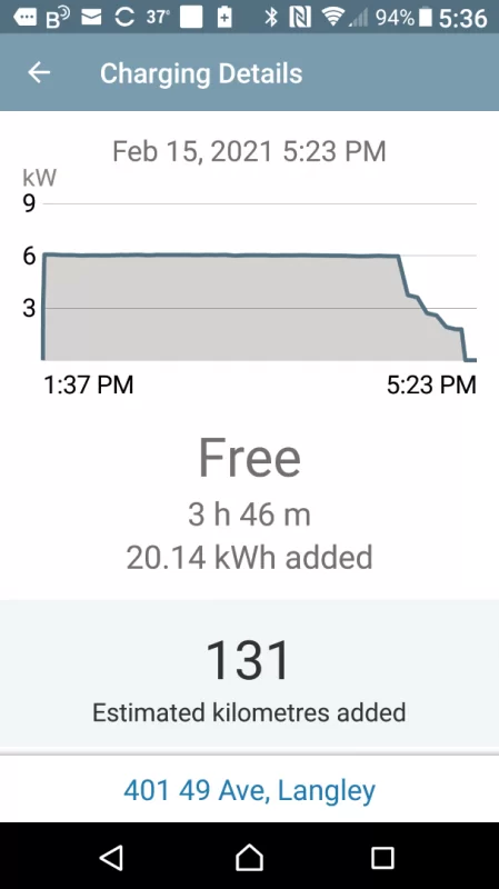

Just charged today to 100%, 2nd time ever (I'm on a roll). We just had our coldest week of this winter, with several days below freezing. Yet my GOM today after the charge still showed 444 kms (after turning Climate off). And like the last time, charge tapered down quickly during the last 1/2 hour. But there was no pause at 80 or 90% like others have reported. Didn't get that the last 100% charge either. And I have had all recall and software updates done on my car.
