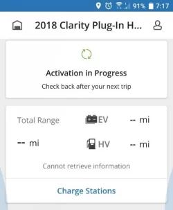

Is this a typical message when trying to set up HondaLink the first time? It's been showing this for about two hours now. The correct mileage does show at the bottom of the app so *something* is communicating properly. I should add that I haven't actually taken a trip like it suggests yet. So that might be it.

All it took was starting the car and backing out of my driveway this morning for the app to complete the connection. Looks like connection was made last night, but it just needed the car to take a short trip to push out the updated battery status, etc.

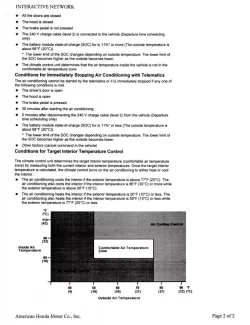

There have been several posts on this but I can’t remember who first posted that it doesn’t follow your settings; it has a set of conditions for inside and outside temperatures that governs it’s settings and even whether or not it will turn on at all.
Here is the diagram of its settings:
