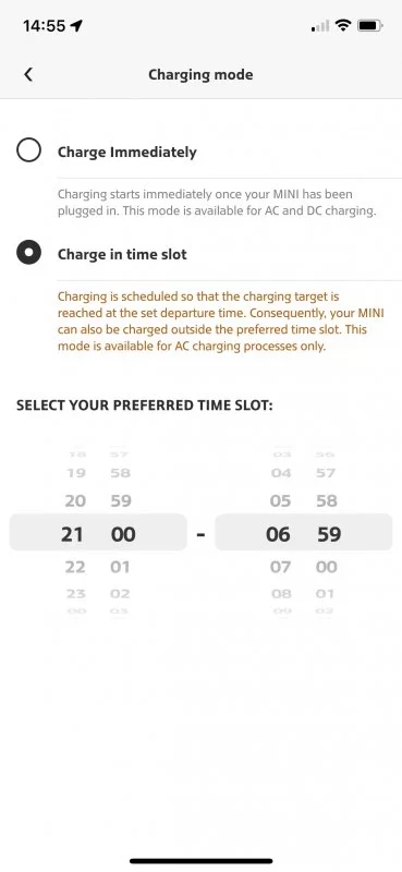

New SE owner here... Question about the scheduling when the car charges. I programmed the app to initiate charging after 9pm (that's when my kwh rate drops a bit), and program it so the car is 100% charged by 7am. But I noticed the car won't actually start charging until many hours past 9pm.... seems like it works backwards.
Meaning it knows it has to be 100% charged by 7am and then works backwards from there to figure out what time it needs to start actually charging. For instance it started charging at 4am this morning (instead of 9pm last night) and was done @100% by 7am.
I'm just curious what the logic might be with doing it this way instead of it just just starting the charging process at 9pm?

If you set your departure time to 29 minutes after your charge window, the SE won't start charging until near the departure time. Example: 21:00-06:31 depart 07:00, charging starts however long before 07:00 to be at 100% by 07:00.
But if you set your departure time to 30 minutes after your charge window, the SE starts charging immediately at the start of the charge window. Example: 21:00-06:30 depart 07:00, charging starts immediately at 21:00.

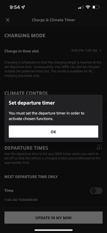

You're able to set a charge window and not set a departure time? If I have no departure time selected, the "low-cost charging for departure" option is disabled. Quick demo:

Hmm this is interesting…whats odd is when I try to go in the app and toggle the departure time OFF, it won’t let me and gives me this message
I got stuck in that loop the other day. In my opinion the app is poorly designed. It definitely forces charging window to be tied to a departure time, which seems unnecessary.
Yeah it could be a bit more intuitive in this section of the app. Got it ok thanks for clarifying
