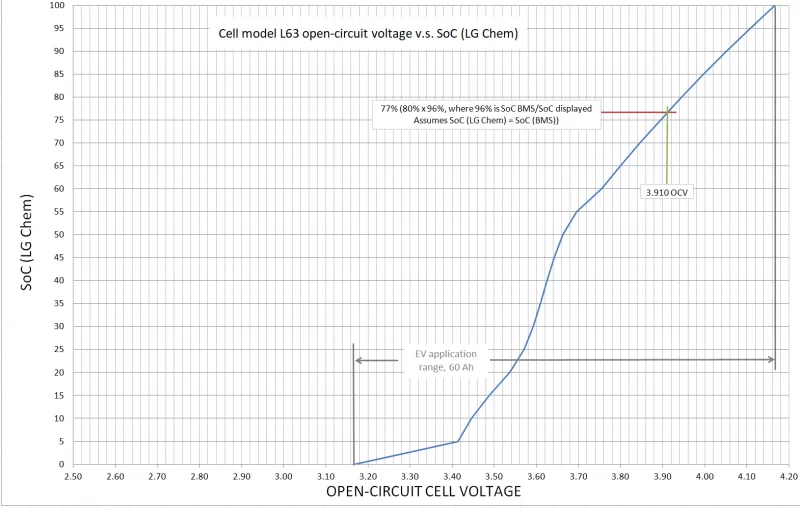

If you've set up an OBD2 dongle and smartphone you can check the changes in the energy (kWh) 'odometers', CEC and CED. The values have a resolution of only 0.5 but that might be good enough for your intentions. Cell voltage might be more accurate (see my plot of LG Chem's E63 definition) but is not easy to translate to energy.
It may not be relevant but on AC charging the efficiency of the on-board charger does vary with current. I'd guess that the published 91% OBC efficiency is at the maximum capacity. At 7 amps (230 VAC) I'm seeing it in the mid-80s. No doubt the losses are not really linear but have fixed and variable components.

Thanks also for including the graph. Very interesting. I have wondered what the battery voltage was, when the Kona goes into Turtle Mode. So if Turtle Mode kicks in at 5% SOC, then the battery voltage would be 3.4 times the number of cells, right?

I had hoped there would be an easier way. I have been thinking of getting an OBD2 dongle, but recall reading elsewhere on this forum that the related app is for an Android phone. (I use an iPhone) ... So if Turtle Mode kicks in at 5% SOC, then the battery voltage would be 3.4 times the number of cells, right?
There's a small device you can buy that does what you want without needing to tie up a smartphone, or you can use apps that that work on the iphone with a WiFi dongle, someone else can perhaps jump in and provide a link.
In theory yes, 3.4 x 98 = 333 VDC, but when you measure it using OBD2 there is a slight load on the battery because the EV is alive so it's not technically a settled "open circuit" reading.
