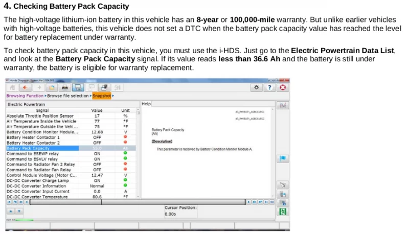

As a condition of purchase I requested that the run a capacity test on the traction battery and, a few days later, they handed me the "traditional" six-page printout. (The capacity was 55.0Ah, btw.)
Just last week I hit the 15,000 mile mark and went to my local dealership for scheduled service. I asked them to run the battery test and generate the same report - I showed them the original: They couldn't determine how to do it. They contacted the regional Honda office: No one there could tell them how to do it.
Do I really need to drive the 135 miles back to the dealership from which I purchased the Clarity or is there a better way to request what I want from my local shop?

you can buy a reader for $27 (https://www.amazon.com/gp/product/B071D8SYXN) and do it yourself.

It is also important to note that this is not a capacity "test". The Clarity constantly monitors the HV battery during the course of normal operation, and the PDI (or the methods we have identified in this forum to obtain the capacity number) simply read the current value out of the vehicle. This number is some kind of long term average and it doesn't really matter what the current State of Charge is...
The last page of the PDI tells the dealer precisely what to do, so there is no excuse for ignorance on their part.
