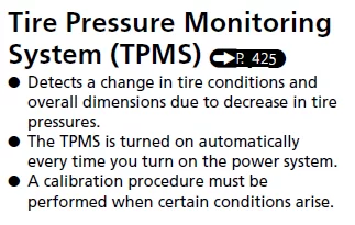

Not in any modern system. Pressure and temperature are read directly and transmitted to the car's pickups. As much as manufacturers tried to do TPMS via wheel-speed sensors and clever software, they eventually admitted defeat and the NHTSA mandated direct read.
The Clarity actually does check each wheel's speed to see if any tires have inconsistent dimensions. That's why the calibration procedure is required.
From page 32 of the Clarity Plug-In Hybrid Owners Manual:

A few folks here have posted that Honda uses the rotation method. And Honda put out a video explaining it.
It definitely is not a “modern” system.
