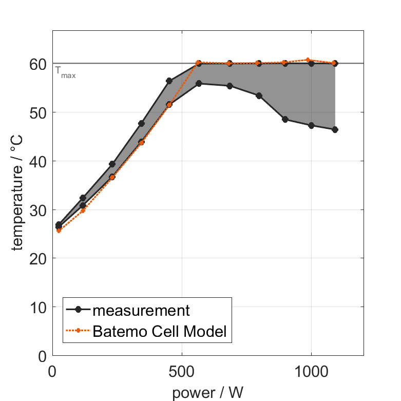

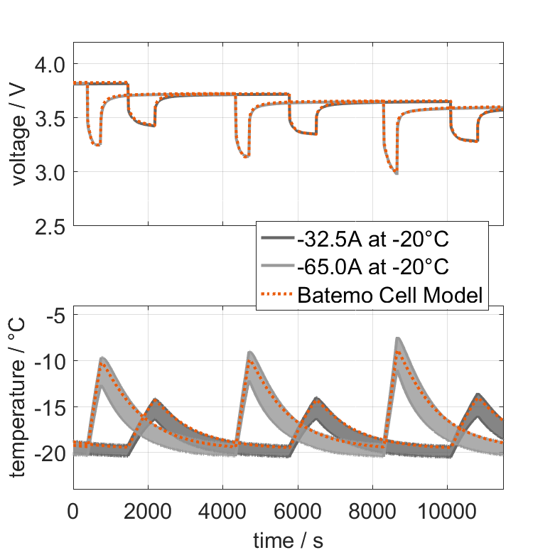

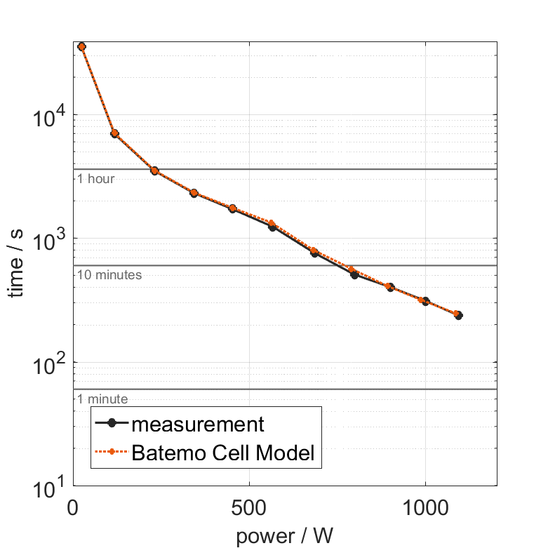

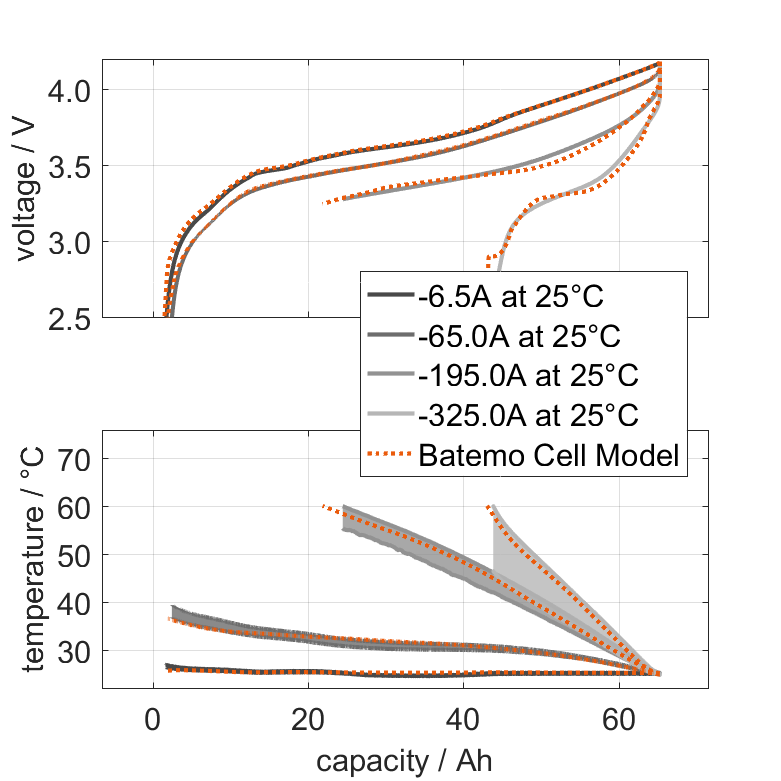

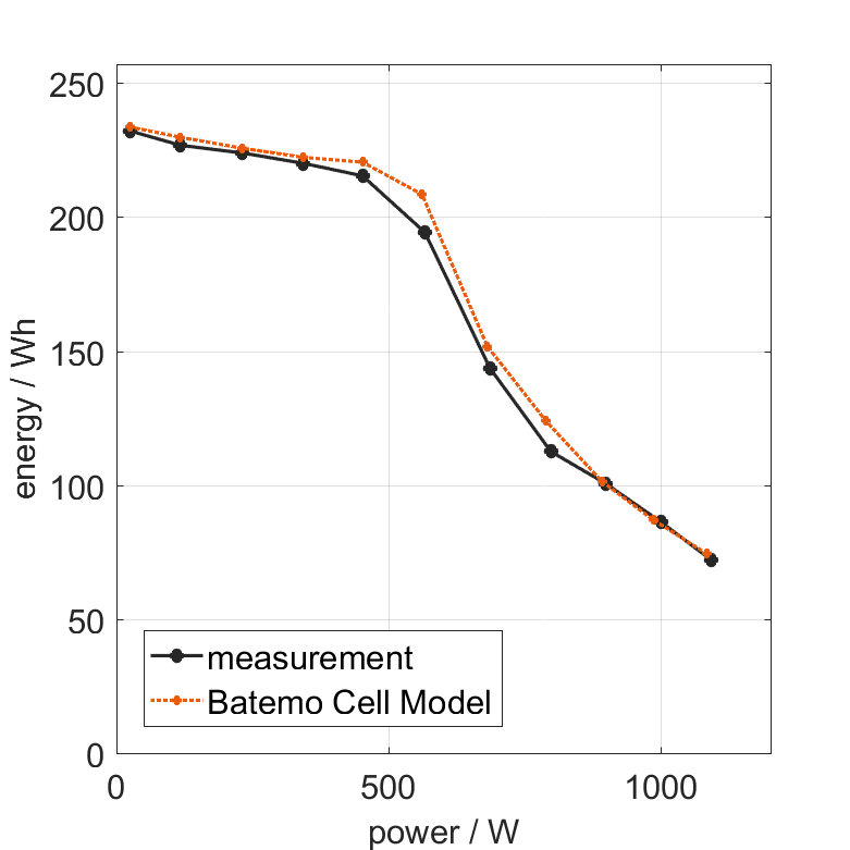

Also much more data here:
Mean Voltage Accuracy 0.028 V 0.9 % Mean Temperature Accuracy 1.2 K 1.5 % Mean Power Accuracy 2.86 W 0.9 % Mean Energy Accuracy 3.310 Wh 2.1 %
State of Charge Range 0 … 100%
Current Range
definition -325 A discharge … 98 A charge (-5.0C … 1.0C)
Voltage Range
definition 2.5 … 4.2 V
Temperature Range
definition -20 … 60 °C
If you find a better reference for the NCM 712 E66a series, please feel free to post here.
