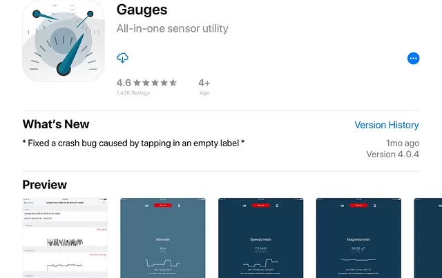

For those with iphones, here’s a versatile little app that displays the output of various sensors in the phone, including a decibel meter:
