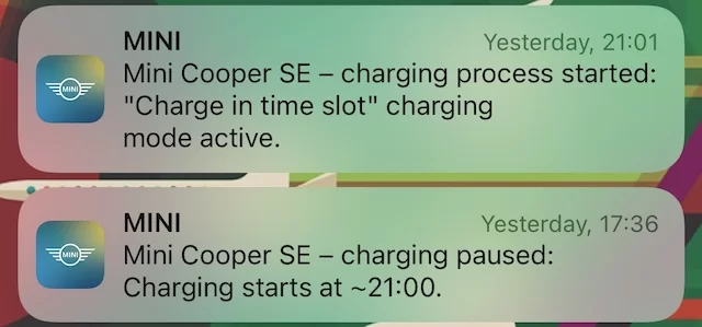

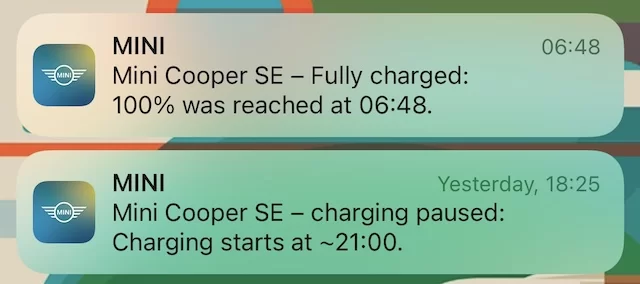

This is how my SE low-cost charging for winter is set:
  • Charge in time slot set, time slot set to 21:00-07:30
  • Automatic climate control for departure turned on
  • Weekly departure time set: 0730 MTWTF
I plug in (Grizzl-E Classic) when I get home, around 18:00. After a brief period of handshaking (blinking green light), the Grizzl-E has a steady green light until the SE starts charging around 03:00 (depending on how much charging is needed), but I don't get a notification since I have do not disturb turned on. Here are the notifications I got for today, where it finished charging at 06:48. The climate control was running at 07:30 when I left.
I did another test, and discovered if you do not have a departure time set (and active for the day), the SE will start charging immediately in the low-cost window. Since it's Saturday, I have no departure time. The SE started charging right away at 21:01.
