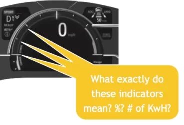

What does each line on the Clarity Power/Charge Gauge indicate?

This is a "power" meter, so shows Kw/horsepower. I am pretty sure it is an absolute measurement, not relative or percentage. Keep the accelerator pedal at constant position and change from econ/normal/sport and you can see the power reading change (because the mapping is different in each mode). I expect the 8 lines are decorative, not intended to align with a specific Kw value.
Thanks. Would be nice if it reflected the power being used in real time, not unlike other cars gauges will switch between units. On that same subject about the only disappointment I have with the Honda Clarity, compared to the models I chose not to buy, is the relative paucity of the information system displays. No way to monitor tire pressure, for example. Am hoping Honda releases a software upgrade to include more information about the car in future versions.
They must represent about 15 kw/20 hp per tick mark (very roughly), just guessing as they force the engine on when power demand exceeds around 120 hp I believe (read it somewhere, but no firm source on that, just a Honda Engineer said such second or third hand).

The gauge is just a relative indication of how much electricity per unit time (the definition of power) is flowing from the batteries to the motor.
Or in lay terms, how fast you are draining the battery. The higher the indicator, the higher the flow and the faster the battery will be drained of it’s usable capacity. It’s useful to help drivers moderate their pedal pressure and acceleration rates and thus achieve better economy. Along with the blue and white curves lines it can help you keep from turning on the ICE.
Moderate accelerarion, steady speeds and anticipating stops instead of jackrabbit starts and heavy braking/regen will yield higher mpg and range, and get you there almost as fast.
