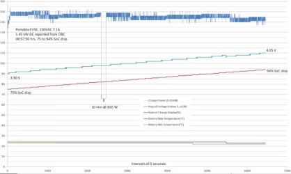

Just for the record here's a graph of trickle charging at around 1.7 kW from 75 to 94% showing the infamous pause at 82%. It's exactly 10 minutes during which it seems to still be charging at a lower rate. The pause has not measurably affected the overall gain of 2%SoC/hour.

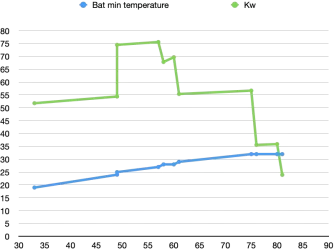

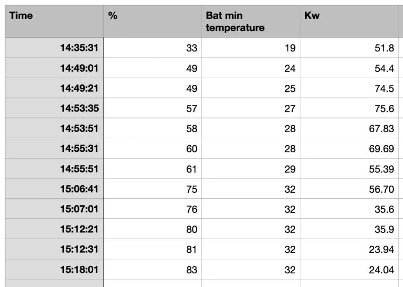

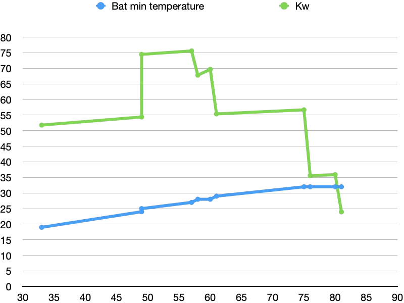

I know a bunch of folks were (legitimately) worried about this, here is a data point from today. This is in California winter, outside temperature around ~21C, so you see it going up from 55kw to 75kw when the battery reaches 25C.

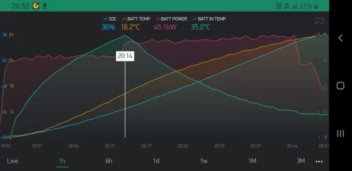

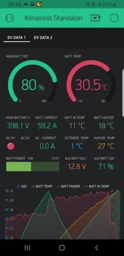

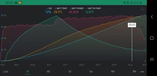

Here you can see on the graph, a charging process, from SOC ~20% to 80%, at 1°C, using a 50kW DC charger (Kona Highway 64kWh 2020 model).
Batt temp was at 6°C and the batt. heater kicked in until 16°C (SOC 36%, in ~25 minutes): Screenshot_20210108-205255_Blynk.webp
Power drops to 34kW at 72%, where batt temp is almost 30°C (in ~55 minutes): Screenshot_20210108-205323_Blynk.webp
At 80% the temp. rised a little bit to 30.5°C: Screenshot_20210108-205603_Blynk.webp

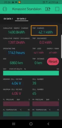

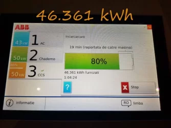

And here you can observe the total energy loss (~9%), during this charge period: TotalEnergy.webp Screenshot_20210108-205607_Blynk1.webp
