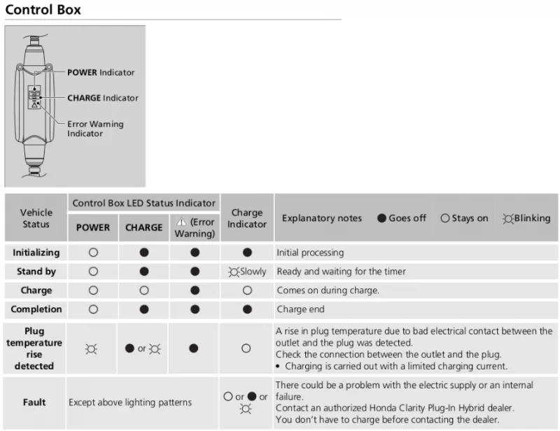

According to the manual, your condition is listed as "Plug temperature rise detected". There is a temperature sensor in in the plug that looks for overheating at that end (could be due to the outlet, the plug, or a poor connection). You should be wary of this because such a problem can lead to a risk of fire. You can initiate a charge, stay there for a while, and feel the temperature of the plug / outlet area with your hand to see if it is getting warm. You do not use an extension cord do you? Extension cords can very much be a weak link and are subject to overheating. I consider them to be temporary work-arounds, and would not use one on a permanent basis.
Here is the relevant snapshot from the manual:

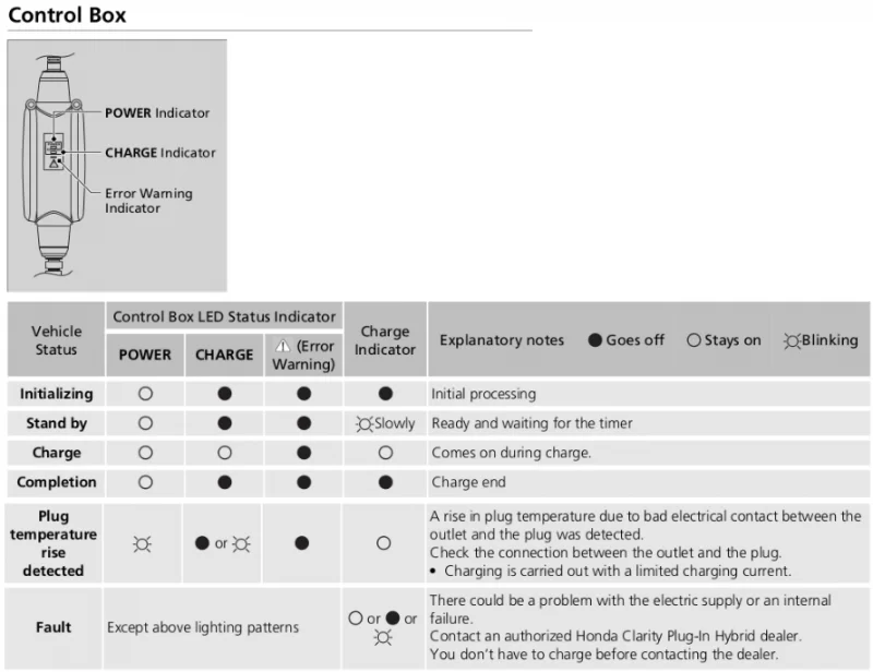

Thank you so much for that table! I tired so very hard to figure out where to find it and never once did I consider the user manual o_O
