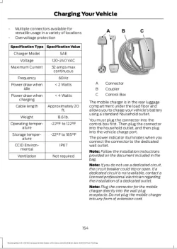

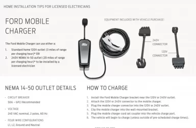

The Mustang Mach e, and Teslas also come with an interchangeable plug so that the EVSE can be operated as a Level 1 or Level 2 just by pluging in a different pig tail plug to the EVSE. Below Is a description of how it works with pictures of the EVSE and the two pig tails. I expect this will start will become more common. The only real difference is between a level 1 and a level 2 EVSE is larger relays in the eves and a heavier cord of on the J1772 side to handle the higher amperage..
Fastnf: Thanks for posting this info.
Question: Do you happen know the nameplate kW rating of the Ford portable EVSE pictured when it's plugged-into a NEMA 14-50 receptacle?
According to the manual the maximum output is 32 amps continuous at 240 volts. Which would be 7.68 KW. The plug is a NEMA 14-50 which will work on a 40 amp or 50 amp circuit
