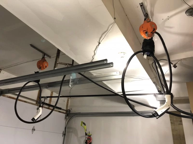

I tried a retractor and found that the tension that built u was much too high by the time it was extended down. I got 2 tool balancers instead that could make the load 'zero gravity' but due to the heavy
EVSE cable unraveling, the weight seen by the balancer decreases due to the self-support (dangling) as the EVSE cable unravels down so it can't maintain 'zero gravity' at all heights. The tool balancer's tension when fully extended, is a fraction of a retractor's so the handle can be pushed high overhead when not in use and then be pulled all the way down to charging level without excessive tension. I highly recommend using a tool balancer if anyone wishes to this type of EVSE setup. The balancer is a cool invention. For a fixed weight hanging from it like a tool with a light cable or wire, it makes it float like its weightless at any height!

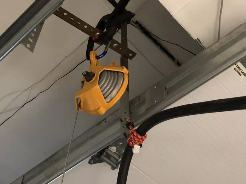

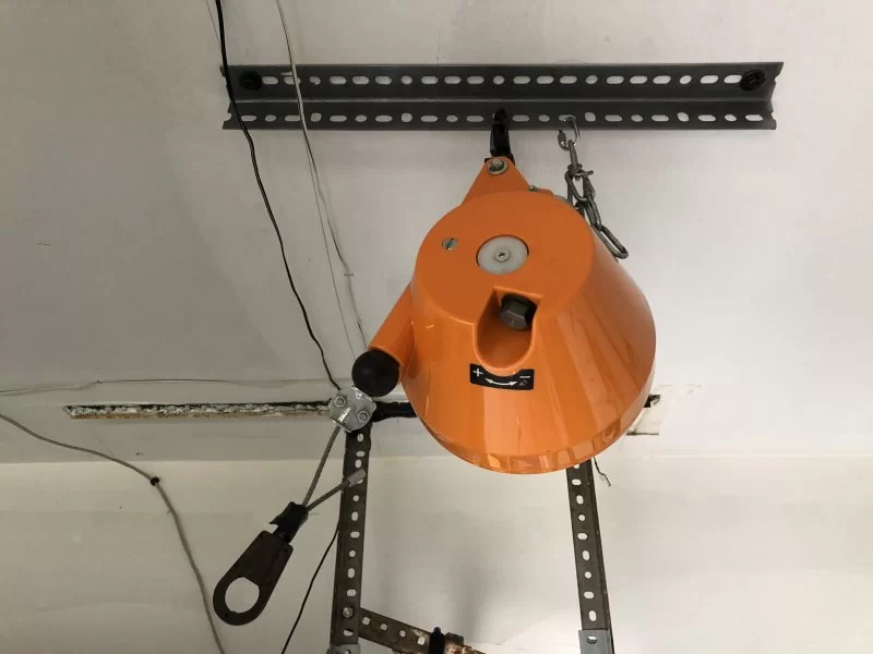

I installed 2 used Packers Kromer 7230-01 'zero-gravity' tool balancers that I found on eBay. They were 12 years old so beware. These ones have a weight range higher than I needed & longer extension so I needed to add 5lb ankle weights to each to increase the total maximum weight be within the 6.6-11 lb operating range. Bungee cords wrapped around to suspend the EVSE cable worked really well without strain, gripped tightly and provided some give if yanked.
Also tried a brand new smaller capacity tool balancer (below was a test run) from China on AliExpress. It worked very well, is completely metal, the weight range was perfectly matched to the power cable, but the extension length was shorter ~135cm. I'm not using it so if anyone is in the Toronto area and is interested in it, PM me and we'll figure something out.
