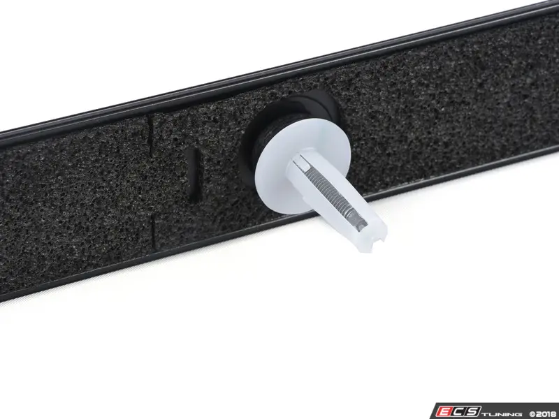

Here is a picture of the underside of the rail
https://c1552172.ssl.cf0.rackcdn.com/1080378_x800.webp
Installation includes drilling out two special rivets holding on the curtain airbag gas generator, removing the airbag clips with a special tool and reinstalling those special rivets/clips when done...
Not impossible but definitely not something most people are equiped to do.
See attached for instructions and page 26 of RCRIT....pdf for the referenced ISTA 72 12 060 procedure (airbag removal)
