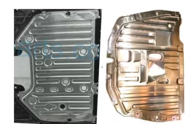

Does anyone have that Civic and the Clarity part to compare the size difference. Maybe a side by side or one on top of the other?
Ah yes. So clearly from the same material, but it's just a cheap stamping, so Honda had no incentive to make this part a parts-bin pull.
Too bad. Given the small # of Clarity produced and the fact that it's discontinued, every parts bin part makes it easier to get a part. If it was a Civic or Accord part, we'd be able to get $20 ones from Honda (or from Ali Express)
For convenience, here are the two covers shown side-by-side (Clarity on the left, Civic on the right):
You can't compare the size because there is no absolute reference for the photos, but you can see that the shape is quite different,
