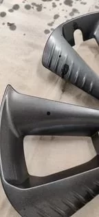

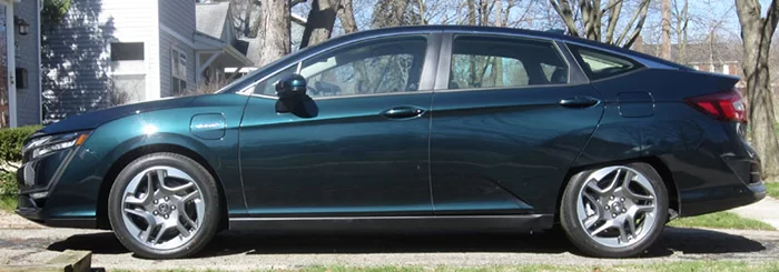

"Painted" the wheels last week
  • Thread starter Thread starter Tek_Freek
  • Replies Replies 18
  • Views Views 3K
Looks good!, In black or some kind of dark gray? The Fuel cell wheels are in gray with black plastic covers. Pretty much looks the same. I was thinking to do something like that too.
Shadow black Hyper Dip. If I was to do it again I'd use a darker black.

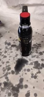

Did it myself. It was not as simple as the videos profess, especially when two of the four cans suffered from what they call "gasket blow by" which results in poor spraying, blobs all over, dripping product down the can and on everything under it, including my shoes.
It's a known problem that they never tell you about. Which is poor business practice to my way of thinking. They offered a replacement or refund. I took the refund. It took six days to get it delivered and I was not going to wait on it that long.
I like the look. It's not "satin smooth" which is what I believe they described the finish as. Somewhat rough to the touch. But unless you get real close the defects can't be seen.
Note: The blobs did level out as I continued applying the spray, but some were still obvious.
Looks good. What tool did you use to remove the plastic pieces? Is the bodyside moulding specific to the Clarity?
I wrapped a screwdriver in cloth and popped every other clip out then pulled with my hands to remove the rest. You have to remove the lug nuts to get them off. I just put the lug nuts back on so I could drive.

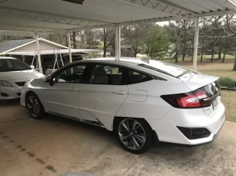

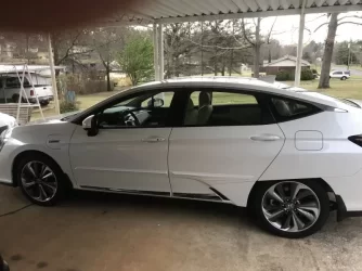

My father in law wanted the chrome pieces on his car. I think it looks fine on the white. My car is black and I didn't want them. Here are a couple of pics of his car:
