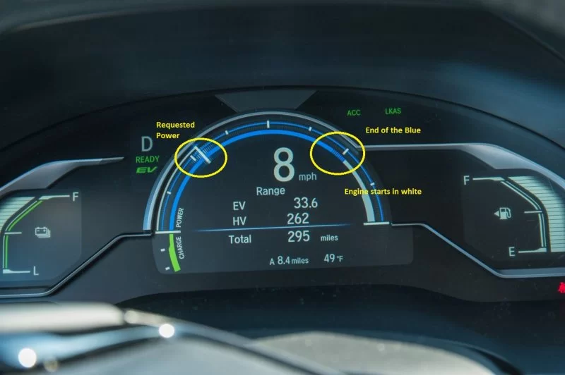

Viking79 ... what do you mean by "if you are right near the end of the blue"? I've seen several references on this forum in general about folks talking about blue versus white but I don't know what they mean. Could you provide a short explanation? Many thanks in advance!!!
On the power meter, on the inside of the arc, a blue or white line appears.
Stay in the blue, no ICE for you! (Unless you stomp on the pedal)
Cross hatched white means ICE may run.
Solid white means ICE will definitely turn on.
From p122 of the manual:
The degree to which the electric motor is being powered is displayed by the readings on the POWER side.When you depress the accelerator pedal, the white needle on the gauge moves. The curved blue line on the gauge shows the range within which only the electric motor provides propulsion to the wheels. The length of this line varies depending on the drive mode and the remaining power of the High Voltage battery. When the white needle exceeds the curved blue line, the engine starts and the curved blue line turns white.
The power output of the electric motor is restricted when the high voltage battery charge level is running low (one segment on the gauge).If you accelerate aggressively, the engine may start even though the white needle has not exceeded the curved blue line.
Sure thing:
As your battery gets down near 0 miles EV range the blue bar slowly grows shorter until the engine starts (at least when cold, haven't tried in summer). The length of the bar represents power available from the battery and depends on a variety of factors although most of the time it looks like in the picture. Pretend the end of the blue is about 120 hp as shown in the picture, battery supposedly puts out 120 hp with the engine able to provide another 60 hp from electricity, if you need more power than the battery can provide the engine starts.
Sport mode quickly jumps up to that limit and if you keep accelerating at the same rate above 30 mph your power needs go up dramatically so the engine starts if you hang out near there.
Thank you very much Ken and Viking! Makes perfect sense to me now.
I always drive in Econ mode and find my Request Power indicator is usually between 10 and 11 o'clock. So I think I've always stayed "in the blue". But I'll keep an closer eye on this now that I understand how it works.
