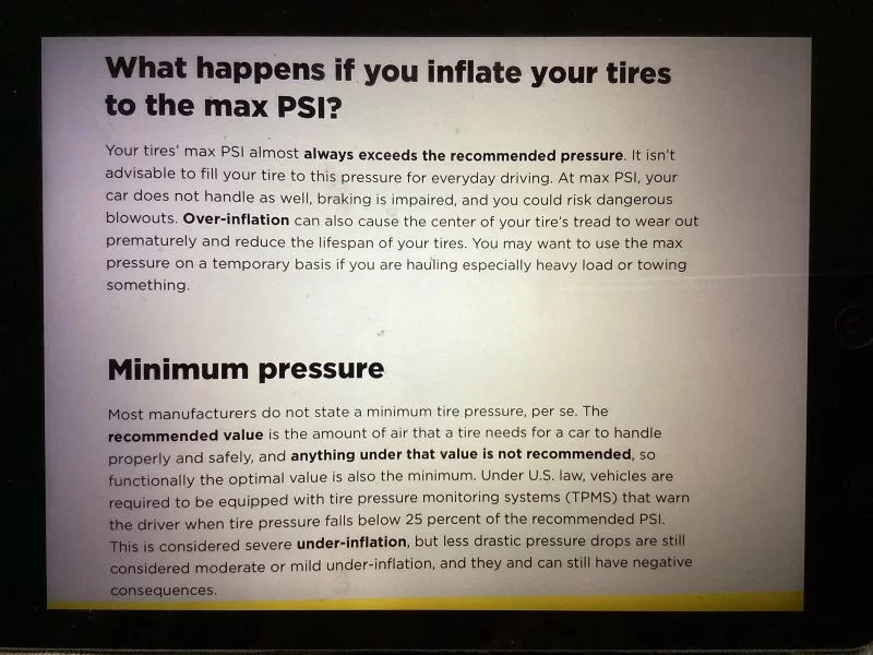

If you are with 40/37 PSI you are 5 PSI above factory recommendation just read this and with directly temperature affects tire pressure for every 10 degrees increase temperature your air pressure will increase by 1 PSI as you are driving in 100’F. Weather your tires will be at 43/40 PSI which is just dangerous and high way speed of 70 M/Hr.increase PSI higher.As I keep my 16” Hankooks at 35/32 PSI as many people complain about wearing mine as new with 16000 miles View attachment 23301
I think that you need to reread this thread.
40/37 is only 2 (not 5) psi over the 38/35 recommended (for stock 17" tires) by MINI USA. It is 2 psi under the recommended (in the UK*) pressure for "ECO". It is 10 psi under the maximum pressure limit for the tire.
As well, nobody here is so naive (I hope) as to not realize that tires heat up when a car is driven (especially when underinflated), and that unless otherwise specified any values mentioned (including by manufacturers) refer only to pressures when cold.
