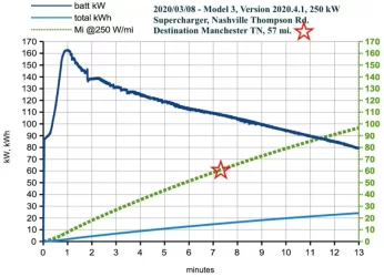

Owner of the slowest charging, Std Rng Plus Model 3, it has a peak charge rate of 170 kW:

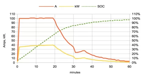

We also have a 2014 BMW i3-REx and its charging curve is limited to <50 kW:
So no, I don't want to charge our BMW i3-REx at a SuperCharger. We'll go to the more expensive CCS-1 chargers. Alternatively, a couple of gallons of gas and not worry about it.
