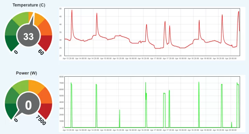

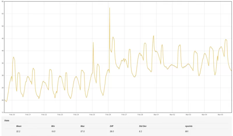

Thanks! That does help, and it does provide another set of data to show that my temperatures are abnormal. My main concern are the excessively high temperatures when the EVSE is sitting idle. I'm getting sensor readings of close to 20°C above ambient when the car is not plugged in (eg. I would have idle temps ranging from 42-50°C when ambient temperatures peaked at 25-30°C during that time period. In contrast, your starting temperature was barely above ambient, which is what I would expect from an idle system.
For example, here's about two weeks worth of temp data from a month ago, when my garage temperatures never hit more than 25C.

I'll be very curious to see your temperature charts when you get the chance to connect your OpenEVSE to the EmonCMS site!
Thank you, geo! This is excellent. And it clearly shows my OpenEVSE has a problem with high idle temperatures. Your idle temp readings are no higher than 5C above ambient temperatures, whereas mine are nearly 20C above ambient (eg. my sensor is currently showing 45C while idle, even though the garage temperature is only 27C. Only thing is, I can't think of anything else to change or fix to try to resolve this temperature issue. :/

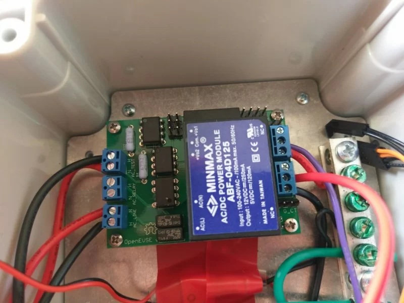

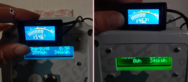

I don't have an infrared thermometer but I did get a digital thermometer probe previously to verify if the temp sensor in the EVSE was accurate. Unfortunately, the temperatures are real, and it is the MinMax AC/DC power module that seems to be the primary culprit. The two pictures below show the temperature with the probe taped to the surface of the power module. The image on the left shows the temperature at night while charging at 10Amps (ambient 21.5 °C, temp1 sensor reading=47.7°C). The image on the right shows the high temperature of 46.2°C while idle (ambient temp = 25.4 °C). The probe shows that the surface temp of the power module is even higher than the reading given by the Temp1 sensor in the OpenEVSE, as that sensor is attached to the LCD screen module and is not in direct contact with the power module. Delta is about 5-7°C.

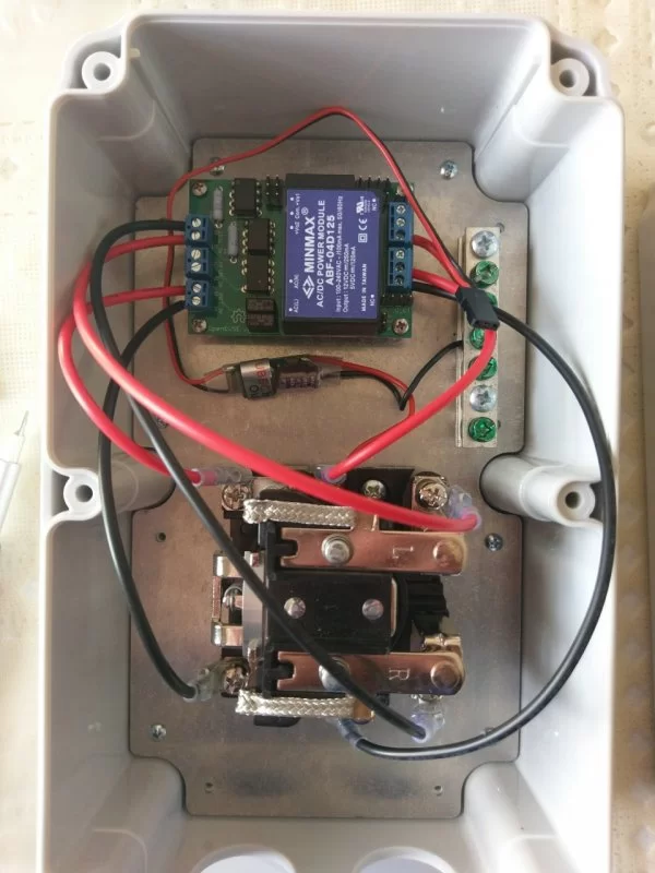

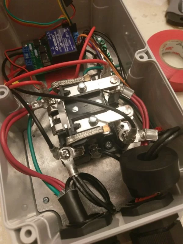

Be any chance do you have any images of your wiring? Here's a few images of mine:
A bit difficult to see, but it sure doesn't seem that my wiring is off.
It looks good from what I can see. You could expect some higher temps on charging because you're using the 12v relay and it probably uses more current to stay closed than the 240 only setup does. However that doesn't explain the higher idle temps.

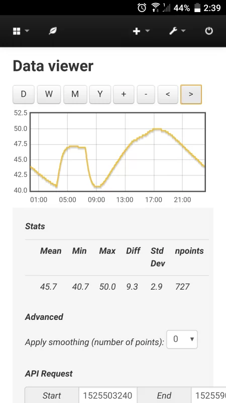

Since this thread is alive again I'll mention that I cut my maximum current to 24 Amps which still give a fast charge time and has kept my chargers internal temperature below 50C. With summer coming up I thought it was worth sacrificing an hour of charge time for cooler electronics.
For my daily overnight night I usually use the lowest 10A setting, in hopes of greatest efficiency and lowest resistive heating losses. The crazy thing is that my EVSE hits higher temperatures during the day sitting idle than when I charge at night (eg yesterday when it got to 50C during the day but only went up to 47.5C while charging -- lower ambient temps overnight, of course). I've come to just accept this as a problem with my particular OpenEVSE as I can't think of any other steps to try to resolve these high idle temps.

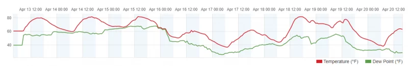

That's a pretty strange temp graph. What was the ambient temperature that day? Unit mounted inside on an exterior wall I assume?

@gmansuperg Yes, it's definitely a strange temperature graph. If you read some of the earlier posts in this thread, I describe some of my troubleshooting attempts on this issue. Unlike most other OpenEVSE temp readings that I've seen, in which idle temps are not much higher than ambient, my idle temps are about 15-20 degrees C above ambient.
My OpenEVSE is mounted inside my garage on an East side wall. So the outside wall gets some sun during the morning, but from around 11-12pm it's in shade. While the wall that the EVSE is mounted on feels warm, it is barely warmer than ambient temp (and I confirmed that today with a contact thermometer on the wall right beside the EVSE. The casing of the EVSE itself feels much hotter in comparison.
In the case of the temp graph I attached today, the outdoor temperature reached a high of 92 F (33C) but inside the garage was no more than 85 F (29.5C) at about 5pm when the temp of the OpenEVSE peaked at 50C. Clearly the power module is active and resistive heating is taking place, to the same degree as it would if the EVSE is actually charging a car. But I can't for the life of me figure out why. Chris Howell (the main OpenEVSE guy) has given up trying to figure out the cause and basically just declared the behavior "normal" and within the temp rating of the module, but clearly something is not normal, as an idle electrical device should not have a temperature that is 20C higher than ambient.
