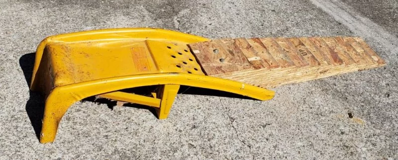

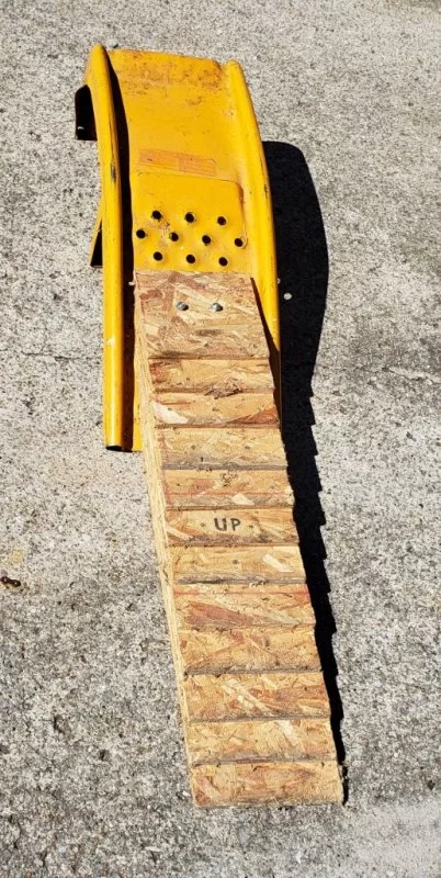

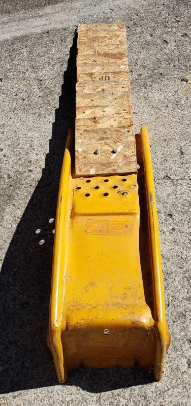

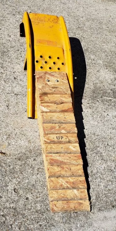

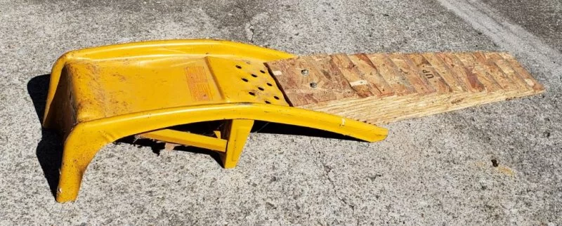

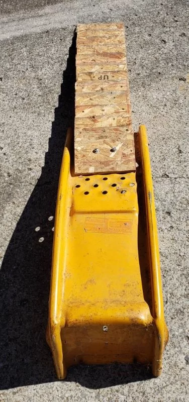

I have traditional metal ramps. Years back when I had a Honda CRX, I had to get creative. I had a piece of 3/8" (I think?) OSB. I calculated out the slope that I wanted (this has been 20+ years ago) and cut the first two pieces (one for each side.). That was maybe 18" long and the width of the ramps. I cut the pieces to the width, laid them on top of the previous one, butted up against the ramp, making each about an inch shorter on the end where you drive onto them. I screwed them together as I went using drywall screws so I wouldn't have anything sticking up that would interfere with subsequent pieces. Eventually I got near the top and stopped adding pieces. The metal ramps have holes in the actual ramp part. I marked a couple of them about halfway up, on the backside of the new wood ramp. Flipped my wood ramp parts over and drilled a couple of holes. I had a couple of U-bolts that were the right width. I put this in from the bottom and secured with a couple of nuts. I can remove the extension easily; but I usually store them with the extension attached, leaned up against the back wall in my garage. I'll try to remember to take a picture soon.

A few pics
