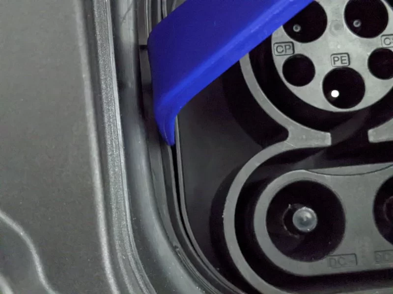

Removing the charge port door/bay:
*If there is an easier way to remove the assembly, let me know, I'd be all for it!*
Open the port door and remove the port covers completely and set them aside. You will need a thin plastic pry tool to slip between the charge ports and the soft rubber trim as pictured.
Any tricks to separating the trim ring from the charge port? I tried this afternoon and nothing felt like it was releasing. I was half-tempted to just grab hold of the entire port door and just pull.
Hey sorry I completely missed my post alert!
It really just takes a little patience and finesse with a thin pry tool. Little pry and pull action usually separates it pretty easily, but the first time is always going to be the hardest. Start in one section and just start working your way around, there is like 4 or 5 tabs that hold it in place.
