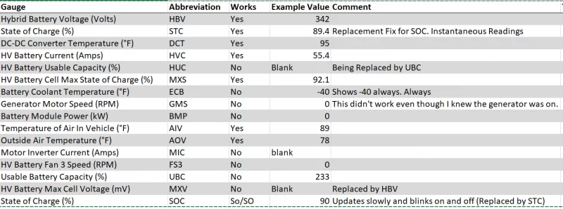

I am working with the XGauge engineer at ScanGauge even as we speak. He sent me a data logger that I connected to the car and let run for 30 minutes and then I sent it back. For the last week or so he has been sending me coding to test and I report back. We have a couple working and there is some very interesting things going on. Continuing to work on the others but it takes time, Honda makes it very difficult to decipher. Will post some off the observations of the PIDs we have working in the next day or two.

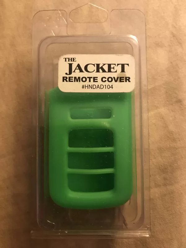

AnthonyW, upon reflection, I’ve decided we all owe you something for your hard work and willingness to share.
I have a silicone cover for the key fob I would like to send you as a thank you from all of us.
If you would like to have it, just PM your address and I’ll send it to you.
Sorry, no color choice.
You didn't like the green?
I got the red one. I can't possibly miss it. Right??!!?

I will post an updated list of PID’s tomorrow. It seems that we have hit a wall and can’t get any further. Not really sure if much time is being put towards the Clarity since it is a niche car. I encourage everyone to go to the website below, scroll to the very bottom and fill out the form. Maybe that will help move things along.
