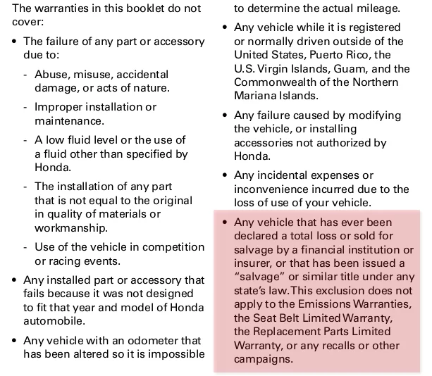

The warranty specifically excludes salvaged vehicles,
BUT this is a little tricky...
The exclusion does not apply to "Emissions Warranties", and the HV battery is considered an "Emissions Part"
I suspect there may be a battle with Honda in your case if you tried to claim a warranty repair on the HV battery.
Here is a section from the warranty manual which specifies this (highlighted in red):
I have attached the warranty manuals to this message...

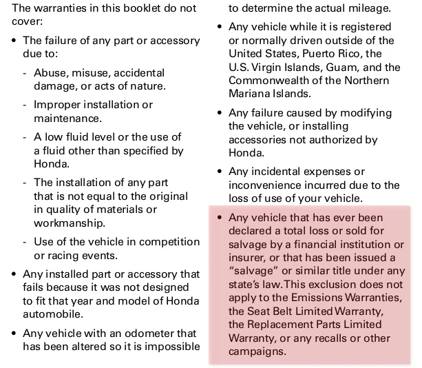

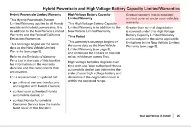

Actually, I don't think "gradually over time is covered". See attached from the 2023 Honda Warranty Basebook.

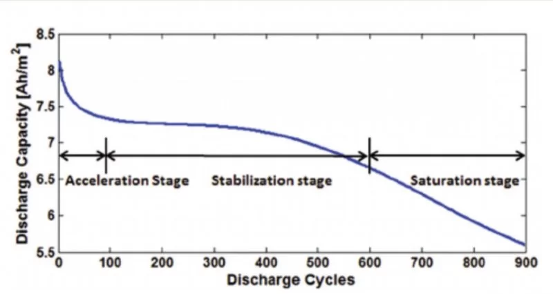

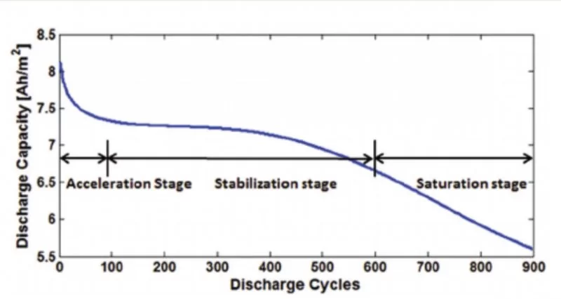

Here’s the chart for that situation.
This figure shows the degradation of a lithium cell that is different from what is used in the Clarity. It is what was observed and measured under specific laboratory conditions. None of us will operate our vehicle in the wild, under those same conditions. That said, the curve gives us a reasonable estimate of what to expect from a lithium battery. Obviously, someone subjecting the battery to conditions wildly different from those used in the laboratory, will get different results.
We have no history on your car. We do know that the battery capacity has decreased about 25% over a 6 year period and would need to decrease another 11-12% over the next 2-4 years and/or 25K-75K miles, depending on the emissions warranty, if applicable, in order to qualify for a replacement under warranty. We can only speculate on where your battery is on the curve. I’d speculate that it is in, or near, the Saturation Stage.
If it were my car, and I confirmed that it would be covered under warranty, I would not be inclined to baby the battery for the duration of the warranty period.

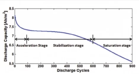

Here’s the chart for that situation. View attachment 23380
