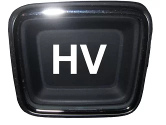

Here's the revised button I created to tape over the D button so I don't forget to press the HV button after stopping on a long trip:
