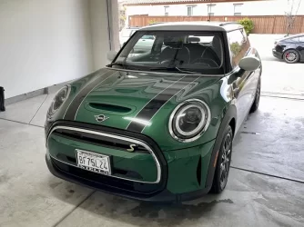

Thank you! Attached are pics of Kermit. Today's project was adding the stripes. Tomorrow I start polishing and ceramic coating. My wife wanted an EV, but didn't need a lot of car. First time experiencing the brand for either of us and must say it's an absolute joy. The fit and finish are excellent. Wife commutes 50 miles daily and it's perfect. I purchased a Tesla Model 3 Performance about a month ago so we are officially all electric and it's so good! Noticed there's quite a bit of new BRGs posted lately. But must say all the Mini colors are fun and any color combo looks fantastic. Cheers :)
Cool combo you have in your garage, @Greyhound2! Congrats on the new SE — looking good; love the stripes! — and welcome to you and your wife and Kermit! :cool:
(P.S. Excellent color choice! ;))
