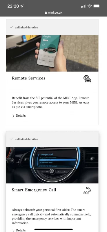

I appreciate the suggestions but unfortunately the problem is not due to remote services not being activated. Mini; both the dealer and Mini’s central helpline have confirmed that all digital services including remote services have been activated for me. Your website suggestion is a good call @azausa. For info you can see all active services via the app too. If you click on the account tab then go to the shop, you’re taken to your account page where you can see what you have and when, in the case of things like concierge services, Mini eDrive services, RTTI etc., they expire. In the UK those particular services are included for 3 years then you need to pay an annual subscription to continue using them. In the app these services show that they’re booked until March 2025 (in my case), so just over three years. Items such as remote services and smart emergency call are included with no expiry date, so when active they have a small tick beside them as you can see in the screenshot below. There is just a problem affecting a number of cars where there’s a communication issue somewhere between the app, Mini’s servers and the car.

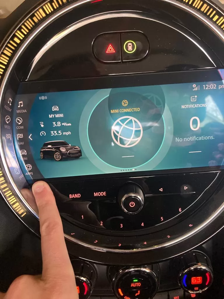

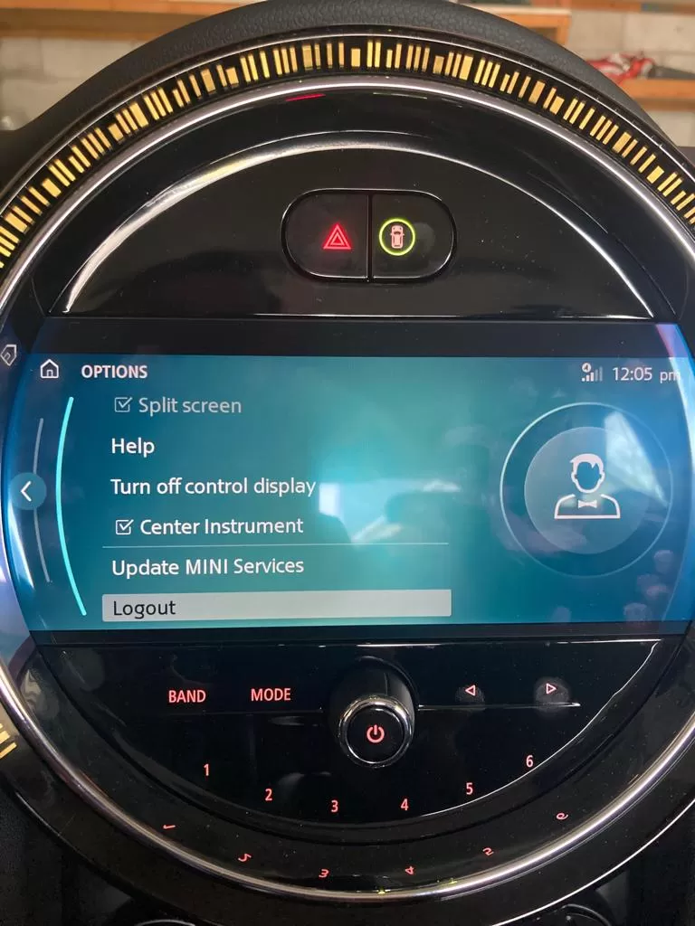

From the main menu:
1) Go to MINI Connected (far right in the Main Menu, alternatively tap the APPS icon on the left side of the screen)
2) inside the menu, click Options on your iDrive controller, and scroll down. You will see Update MINI Services, and either Login or Logout. If you see Login, well, Login (using your mini connected info, same as the app).
Let me know if that works!

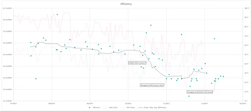

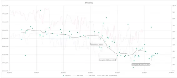

Also created a graph showing long term averages

So my remote functions work now too. But not the climate timer thing. I took the advise here and signed into mini connected in the car and updated the data. Hopefully it works soon.
