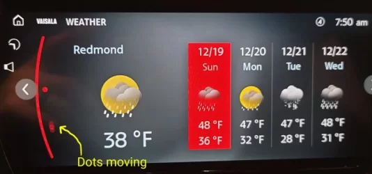

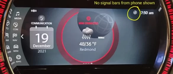

Disconnect all phones from the car (to ensure data isn't coming from Bluetooth) then go to MINI connected and try to get the weather to refresh.
You can also try another location just to be sure. It should have some dots moving up and down on the left side for a bit then they'll stop.
If the weather refreshes, that proves the car has data signal. From there I'd try uninstalling/wiping the MINI app to see if that helps.
If the weather won't refresh, try repeating the same steps somewhere else (a decent size city?).
Even if this doesn't solve the issue, it should be helpful info for MINI to start their troubleshooting.

I removed my phone from the car, refreshed the weather/changed cities, browsed the news then reinstalled the app and still nothing. I even logged out from Mini Assist then logged back in and updated services again, nothing.

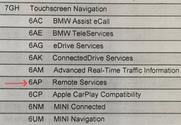

MINI remote services is a separate thing from the other MINI connected stuff so maybe that bit wasn't activated properly. Just to confirm, does your build sheet show "6AP" remote services?

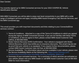

Did you get this email or similar from MINI? You may have already tried but I'd suggest #4 about what is actually activated for your car.
I’ve never had a build sheet from Mini with the three digit codes. I know others who have ordered ICE Minis from this dealer and they didn’t get build sheets like that either. I don’t know if a build sheet like that could be US only? What I got is basically a print out of the configurator at the time I ordered the car and it shows remote services. The helpline this morning confirmed there was a known issue with remote services on some cars and they are working on a fix. They confirmed my Mini has remote services and should be active, they’re just not getting through Mini’s server. I don’t know if you’ve called the US helpline but on the UK one there is an automated message before you get through to an advisor stating that they are aware of issues with Connected Drive/Mini Connected services and are working to resolve them asap. I have had a similar email to the one you have posted (thanks for that) when the car was added to the account yesterday. I think I’m just going to have to try to be patient until they fix it.

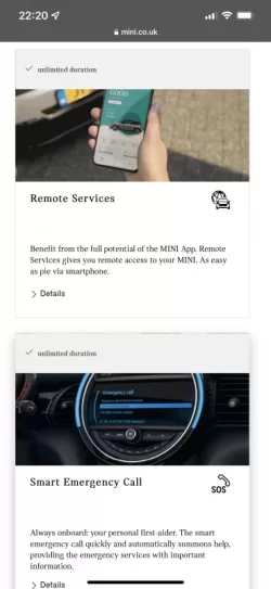

MINI NZ gave me a link to MINI Connected NZ site, where I log in with the account that I setup with my dealer. Here I can see the status of the following services: Digital Services (Concierge Services, MINI Online / SIM, Connected Services / App, Map Update, RTTI, Online Speech, Digital Services (Remote Services / App, Teleservices / Service Check, Emergency Call, CarPlay). Probably different but this was were I checked if my remote services were active or not.
I appreciate the suggestions but unfortunately the problem is not due to remote services not being activated. Mini; both the dealer and Mini’s central helpline have confirmed that all digital services including remote services have been activated for me. Your website suggestion is a good call @azausa. For info you can see all active services via the app too. If you click on the account tab then go to the shop, you’re taken to your account page where you can see what you have and when, in the case of things like concierge services, Mini eDrive services, RTTI etc., they expire. In the UK those particular services are included for 3 years then you need to pay an annual subscription to continue using them. In the app these services show that they’re booked until March 2025 (in my case), so just over three years. Items such as remote services and smart emergency call are included with no expiry date, so when active they have a small tick beside them as you can see in the screenshot below. There is just a problem affecting a number of cars where there’s a communication issue somewhere between the app, Mini’s servers and the car.
