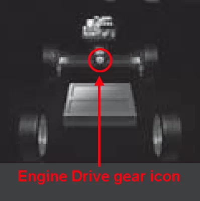

Engine drive mode is when the gear icon appears to indicate the i-MMD system has engaged the Engine-drive clutch so that the ICE is mechanically connected through gears to drive the front wheels. It turns out that this direct connection is the most efficient method of powering the car in some instances, such as when the load is light at expressway speeds.
One clarification needed. Where is this gear icon of which you speak? I've looked for it both on the car and in the manual and cannot find it. thanks
Haven’t seen mine in a while, but I’m pretty sure it illuminates between the engine icon and battery gauge on the vehicle energy screen at the intersection of the energy flows to and from the engine, wheels and battery. You’ll only see it in HV when the engine is running with the engine icon is illuminated. Mine goes on and off on multiple times on the interstate. It has a narrow torque and specific rpm range so hills will cause it to declutch and you won’t see it below 50ish mph.
@KentuckyKen is right. I tried to blow up the illustration from page 14 in the Owners Manual. The illustration is so small that it just got fuzzier. So I drew a red circle around the icon so you can at least know where to look on the Energy Flow screen.
Ok I will put that screen up and watch for it. Unlike most of the people on this forum most of my driving is not in EV mode but in HV so I want to understand how that works better. 40 miles doesn't get me very far most days!
I had the same question about the location of the gear icon. Today I finally figured out where it was and why I hadn't noticed it before. Usually when I am in hybrid mode, I have the Android Auto screen on.
Driving home, I had the Energy Flow screen on in HV mode and noticed that at the junction of the engine and motor energy flows to the wheels there was a tiny tiny tiny thingy which came and went. Bingo, I realized that this must be the gear icon everyone mentioned.
Let me tell you, the only reason you never noticed it is because you were driving without a magnifying glass.

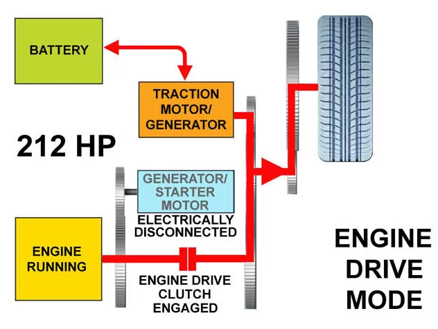

So I found the gear icon today but also found why I hadn't noticed it before. 90% of my highway driving lately is on Connecticut Route 9, and it is all up and down hills to the point that maybe 1 mile out of 30 showed the gear icon. When you're going uphill engaging the gear doesn't give enough power/revs to get you up the hill so it all goes thru the generator, and downhill the engine goes off. I also today drove Interstate 95 and that is flat enough that the gear icon was on more than half the time.
You've hit on one of the more perplexing aspects of the Clarity PHEV. Only when the clutch is engaged (Engine Drive mode) is Honda's claim of 212 hp available (see Engine Drive mode illustration below--see illustration of all modes here). If that's so, why does the car have to switch to the 181-hp EV Drive mode when you need max power? The answer has to be the gas-saving tall gearing used for Engine Drive mode.

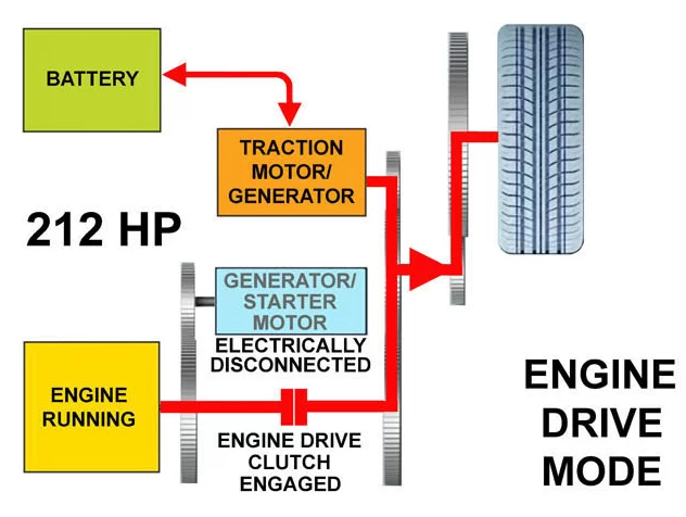

That's my guess too. With the tall gearing the engine is likely way below its hp peak at normal highway speeds. I would offer to try cruising route 9 at 100 mph and see if it stays in engine drive mode more, my guess is it would, but that road is always crawling with police ;).
