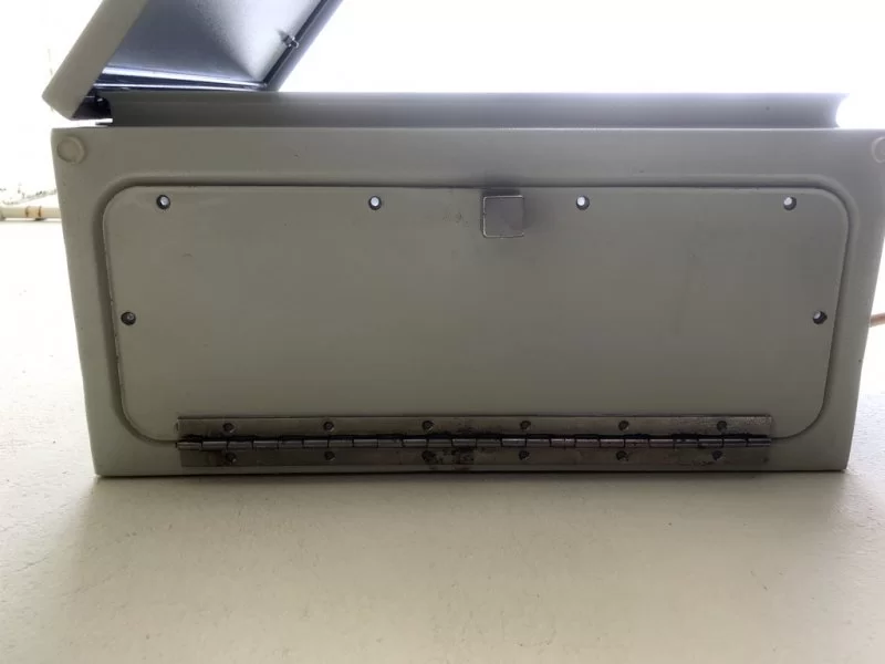

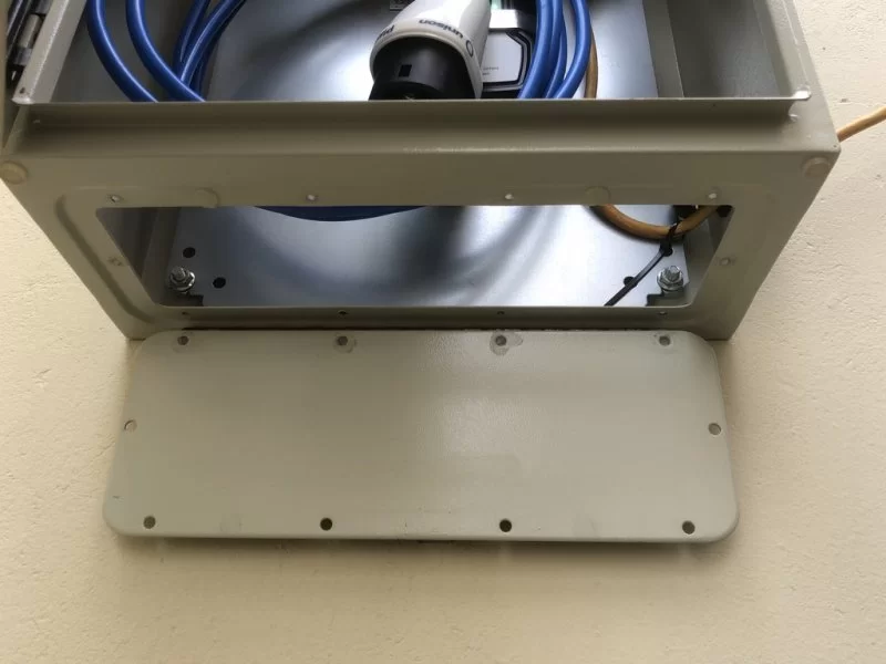

These also normally have a removable, gasketed panel at one end, intended to be modified to pass electrical conduit. I used a piano hinge and a strong magnet to make that into an underside door that allows the charging cable to hang out the bottom with the main door closed.
Then just have an electrician run power and install a standard power outlet on the panel, or DIY if you can.
