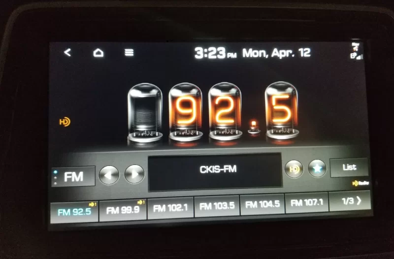

I had a 2020 Kona Ultimate. I loved my Radio, Climate Control, and Home Screen Widgets. I don't have time to go into all that has happened but I will try to summarize here. After 18 Months my Phone's Memory in the car would not hold my contacts. The Dealer tried his phone plus another tech's phone with the same result. The Dealer concluded the Radio Head unit had to be replaced. They replaced it. The Exterior was exactly the same. Same Color, Perfect Fit, It Looked Exactly like my original unit, ON THE OUTSIDE. But the Radio and the Climate Control were Completely Different plus the Widgets were also gone. All I had left were Home Screen Icons..
Here is a photo of my Original Radio and Home Screen. (Ignore the date - I just took this photo yesterday. I took this photo off my new 2021 Kona Ultimate which is the same system that was in my 2020 which Hyundai could not "locate" for me between December 2020 and July 2021)

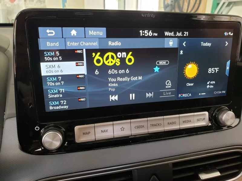

Now here is what the Radio Looked like after they replaced the Radio Head Unit. (I forgot to take a photo of the radio that I was stuck with for 6 months and hated, so I found this photo on the internet listed under Hyundai Radio Images. It is close enough to make my point. This TUBE Radio was included in the Radio Head Hyundai installed in December 2020).
Looking at these two photos can you understand why I hated the Tube Style Radio! My Climate control was also changed and the Widgets were also removed plus a few other things. Now here is the Real Kicker. According to Hyundai AutoEver which used to be called MapnSoft the Navigation System that came in my 2021 Kona Ultimate is Version 13.something and is way out of date. They said it needs to be updated. I asked them one question. If I update the Navigation to the latest version will it change my Radio and Climate Control? They sent me an email stating Yes, they would also change. So I will not be updating my Navigation. Heck, all it does anyway is add a few new streets and change a few speed limits. I don't need them.
There is a lot more I can tell you but I don't have the time right now. My main message is to be careful what you update. You may be getting more than a Map Update. You may be getting a Nightmare. Hope this helps.
