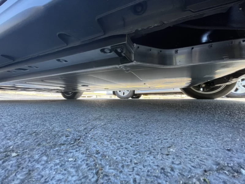

MikeP
Like new again at 31k miles, in Kentucky.
Replacement took about 6.5 hrs, which included a 50mi test drive.
