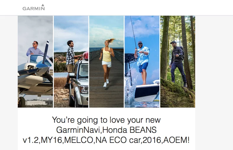

Doing my first map update. A) for a car purchased a month ago, there is one. B) I love this cheery welcome message from Garmin, with the name that just flows off the tongue. I'll call my map "Honda Bean" from now on.
Initial estimate for the download time was three hours, turned out to be about 30 minutes. Almost 8 GB downloaded! I'm going to wait for my next long drive to install it.
