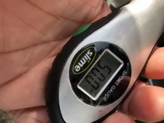

Drove about 125 miles in overinflated tires.
Was going to check at delivery but forgot. Then wanted to do it when the tires were cold. Finally did it this morning.
All four tires set to 50psi

Great for range and mileage but terrible for ride and safety. I too had to let out a bunch of air to get my tires to 36 psi.
I had my clarity for a month before realizing that the tires were set to 50. I released air to set them to 36. What is this case that you filed with Honda?
Why are they all set to 50-psi? Mine was the same.
Seems like it is not just one or two dealers doing this. Are the cars leaving Japan that way, or is someone at the port of entry using a bad tire gauge when they prep the cars unloaded from the ship?
Or could it be that Honda sent a bulletin to the dealers advising them to set tire pressure that high for who knows what reason?
That's how Honda ships their cars. I've speculated the high tire pressure is likely used to minimize the ability of the car to move around when it's locked down using the oval holes where the infamous rubber plugs are supposed to be installed by the dealer.

During shipping they set the presssure at 50psi. Mostly like the pressure is that high becaus how they strap the cars down on the boat. After it gets to the dealer they are supposed to set the pressure to the correct level along with all the other make ready items but most dealerships intrust this job to the lowest paid person on the lot and most likely tell them they have to do X many a day or they will be fired. At that point this person is trying to keep their job and makes them visually look good enough to not get in trouble. We at that point get mad and complain about on the internet and to the NHTSA thinking it will make a difference because the get off my lawn gene seems to run deep for a clarity owners
I drove about 1000 miles before realizing my tires were at 50psi. I wonder if I've caused them any damage? I have now deflated them to 36 but can't really tell the difference in the ride. However, driving for so long at 50 may have accelerated the wear along the center. I may go to a tire shop and have them assess it.

I read in a thread that Honda over inflates the tires to prevent them from developing a flat spot when being either strapped down or sitting on the lot for several weeks or months. Made sense to me. Imagine how it would feel test driving a new car with a flat spot you could feel as you got the speed up. I did find mine at 50psi also.
