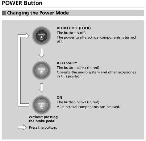

It is my understanding, or misunderstanding, that pressing the ON button twice, without pressing the brake, or pressing it once, while pressing the brake, puts the car in the same mode.
Unless you then press the HV button, the car will be in EV, by default. In EV, the HV battery will charge the 12V battery through a DC/DC converter. It will charge the 12V battery until it is depleted (EV range 0 miles), at which point the car will put itself in HV mode.
In HV, the engine will start to maintain the HV battery SOC set point and the HV battery will continue to charge the 12V battery. The engine never charges the 12V battery directly.
I recommend purchasing at 12V lithium jump pack.
"ON" mode (two presses of the power switch without pressing the brake pedal) runs everything off of the 12V battery. Neither heat or AC are available in ON mode, you can only run the fan. You can quite easily run down the 12V battery in ON mode. ACC mode (one press of the power switch without pressing the brake pedal) runs only the infotainment system, and it powers off after around 30 minutes. ON mode however has no such timer and will happily let you kill your 12V.
Only while in READY mode is the traction battery supplying power, and the only mode (other than remote climate) that provides heat or AC. The way to check if you have inadvertently put it into ON mode is to look for READY. If it doesn't say READY on the dash, then you are in ON mode. READY mode is really the only mode that should be used while sitting in the car for any length of time. The drain on the traction battery is minimal, although if you are low on EV range and run the heater or AC for an extended period, the SOC will drop below 10%, at around 3% it will start up ICE to charge the traction battery back up around 5%, then shut off again down to 3%, in other words ICE will run for a few minutes every ten minutes or so, depending on the power demand. But as long as you have EV miles that won't happen and ICE will not come on.
Also note turning on HV mode and just sitting there will *not* turn on the engine. It is a guaranteed way to get "angry bees" if you want them, though. Go HV, stop and drain a frw estimated miles either by heat or high A/C for 15 minutes, then drive again and listen to it make a manic effort to recover those few miles and get the HV range back to where it was before you stopped. I am curious what the behavior would be if those few miles were all you had left of EV range. Would it kill both the 12v and traction, or would it finally kick on the generator?

NO -- that's a recipe for draining the battery; it puts the car in "On" mode without starting the HV system, similar to just turning an ignition key 2 positions (Off->Acc->On) without starting it.

Pressing the power button with foot off brake once goes to Accessory mode -- radio, 12V outlets, and some other things work. Pressing it twice with foot off brake goes to On mode (not to be confused with Ready) -- in addition to those items, the HVAC fan (but not AC or heater itself) works too, meaning it's an even bigger drain on the 12V battery. In both cases the HV system is off and not providing any power via the DC-DC converter.
OP -- are you absolutely sure the car was in "Ready" mode? Leaving with the key should beep warnings but shouldn't stop the car (because, for example, driving away from someone you dropped off who has the key and having the car die in the middle of the road a half block away would be dangerous). What was the temperature outside -- are you sure she was getting actual heat, or just residual ambient air from the fan?
And the Clarity's huge DRL's (daytime running lights) will be on also, adding significanty to the drain on the 12V battery while in ON mode. Unless they happened to have set the parking brake prior to turning the car back on, or had Brake Hold active when the car was shut off.
They most definitely were not in READY mode, as there is no way that the 12V battery will drain and cause the car to shut off while in READY mode, and require a jump start to get the car running again. Think about it, if it could do this while in READY mode then it could happen while driving down the freeway just as easily as it could while parked. But this won't happen in READY mode because the 12V battery is not providing any power in that mode, as you mentioned it's all coming from the DC-DC converter at that time, just as it comes from the alternator in a gas car when it is running.
Another detail that we can fill in that wasn't mentioned is that the car was shut off after pulling into the parking spot, then turned back on (but inadvertently to ON mode) prior to the OP going into the store. If they had parked and not shut off the car and then went into the store it would have remained in READY mode and everything would have been fine.
An easy way this can happen is if someone starts to get out of the car, then decides to turn it back on, and reaches back in and presses the power button, which it will let you do even if you aren't sitting in the car. Although in this case since their foot isn't on the brake the first press will be Accessory Mode. It won't seem to start the car so people will naturally press it again and when they see the dash light up in the familiar looking way they will be satisfied that the car is now running. When in fact it is not running, it is in ON mode, aka "12V Battery Death Mode"
