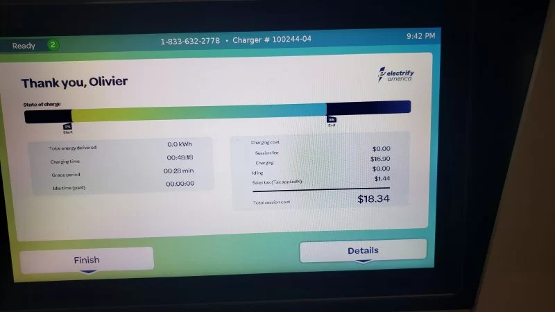

Charging was kind of disappointing .
Tried with the regular plan it it charged me .58 per minute, so I switched to Hyundai plan.
Started at 12% at 72kw but soon dropped to 66kw and stayed 66 to 69kw until 54%, then dropped to 44kw to 48kw where it stayed until 75%.. dropped to 35kw at 76% and to 24kw at 78%
I stopped charging when it dropped to 24kw..

From stageshoot over at SpeakEVs we have a similar test on an Ionity 150kW posted today with a very warm battery, 34°C ending at 46°C. At risk of raining on his parade, here are his numbers in summary (left column) compared with yours (right column):
12% to 60% 71Kw+ --------- 12% to 54% 66-72kW
60% to 76% 56Kw ---------- 54% to 75% 44-48kW
76% to 80% 36Kw ---------- 75% to 78% 35kW, 78% 24kW

TMS was on most of my session.. Florida is hot.. I also drove fast before I got there to run down the battery for more data..

A little too much to ask for on this update, I guess. Thanks for trying. Just have to hope competition will help sway in our favor:(
