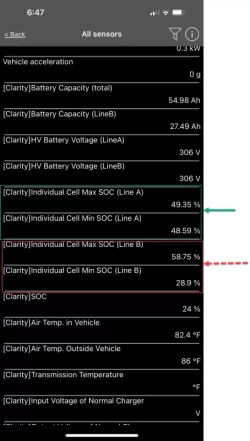

You may notice that the battery capacity shows 54.98 in the screenshot above. The reading was taken after I took it into Honda the first time. They reset the DTC's and magically the capacity went up from 48.4 to 54.98. Of course that is not possible but I imagine they reset the value so that the car could recalculate it from a fresh start. I don't know how long that would take but it never happened in the weeks I had the car before the replacement.
So as you can see while pack A is less than 1% apart pack b has a 30% gap. Even when fully charged the gap was never less than 5% Sometimes pack b would get stuck and not do anything. They car actually drove better when that happened even though I only had 20 miles of range:

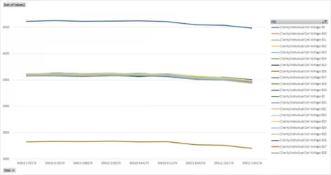

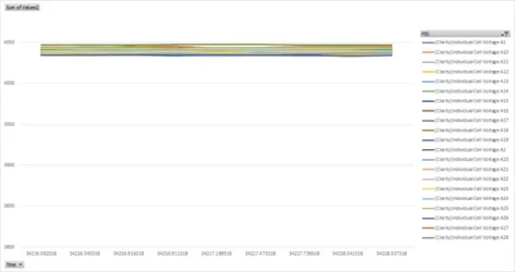

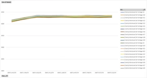

I eventually found the culprit. 2 cells were throwing everything out of whack. They were B67 and B68. I made a chart of the Car Scanner data and as you can see 82 out of the 84 cells in pack b are right close together. The remaining 2 are the outliers and seemingly the main culprit.
Note that I scaled the next 4 voltage charts voltage range on the y axis and time steps on the x axis so that visually they are all apples to apples.
Pack B voltage by cell distribution
index.php
Here is pack A:

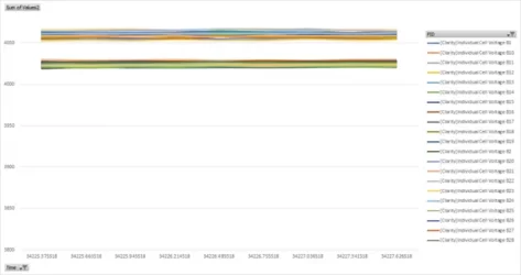

Here is the voltage of new pack B (remember this is to same scale as the 2 voltage charts above and one below):
index.php
Here is the voltage of new pack A
index.php
Oh well, there is nothing I can do about it for now but keep an eye on it. Maybe over time the cells voltage range will tighten up. I have had it for 10 days now and have "exercised" it a bit by fully charging it and running it down to 30% and the gaps still persists.

On your "New", "Pack B" plot, there are 2 distinctive groups. It looks like roughly half of the cells are low. The text is hard to read, but is there a pattern to the cells that are grouped together (for instance, are all the odd cells low and the even ones high)?
I don't know enough about the architecture but obviously this doesn't look like a random selection of cells. Either there is something systematic about the way they get charged in groups, or the cells themselves that caused these groupings. Could it be that Honda bins these cells and this pack was fabricated from whatever bins were left over at the end of the production run (or similar). It may be perfectly OK if these groupings correspond to the interconnection architecture such that the low cells are balanced with the other lows and the high cells are balanced with the other highs.
Again, i know nearly nothing here, but are there charging parts upstream that could be affecting specific packs or cells? I.e. to point above, are certain cells charged off 1 trunk?

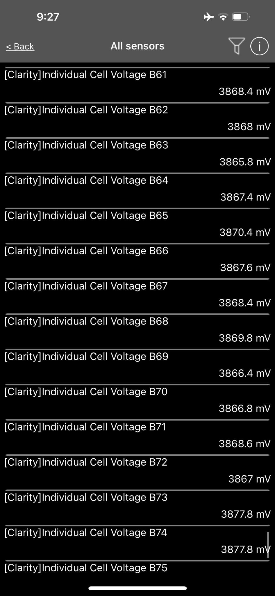

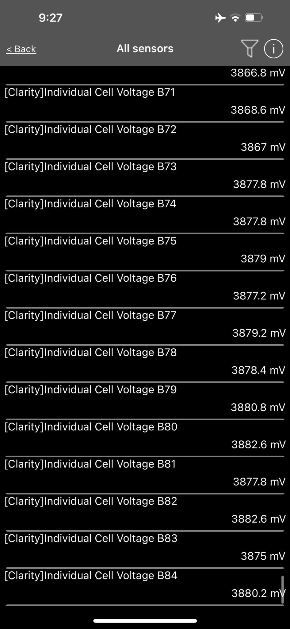

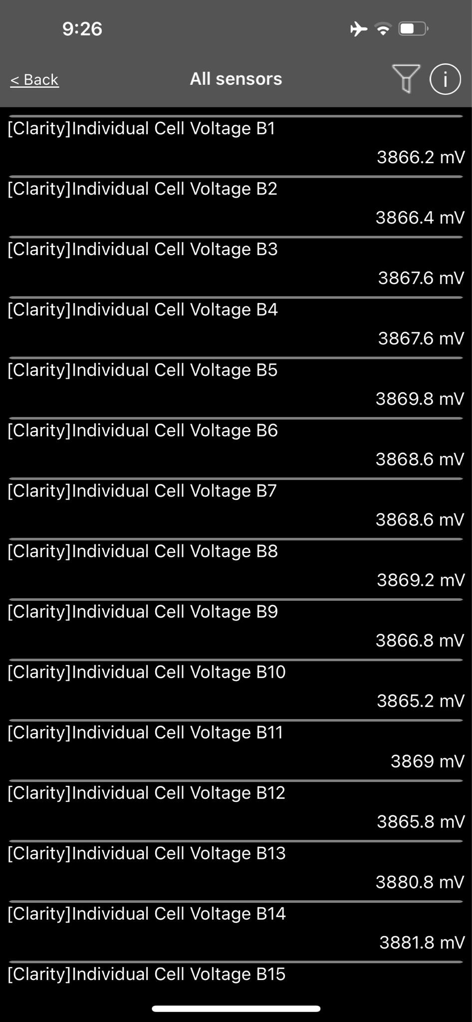

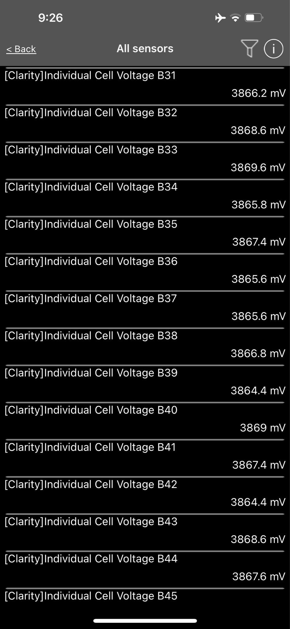

I haven’t had the time to really dig into it since I figured out how to export the Car Scanner data recording. My work is in data analytics and statistical analysis so I am going to gather all the data into an Access database and see what correlations and trends I can identify.

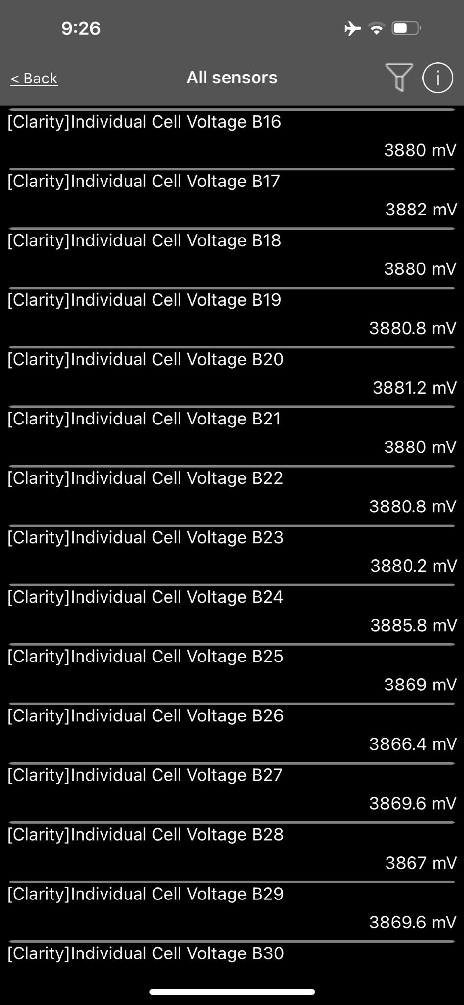

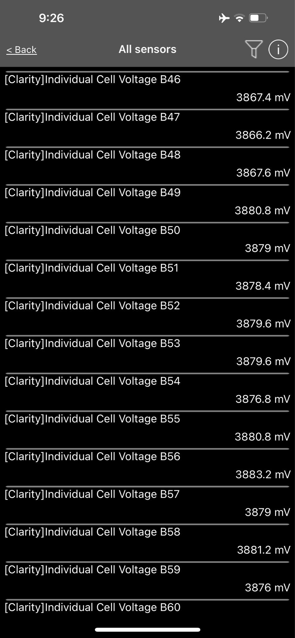

A quick visual check may support your thoughts of a refurbished pack. There does appear to be a pattern in the 7 banks (12 cells each). In each bank the voltage of each cell is very close. When comparing banks as a whole it looks like banks 1,3,4, and 6 are within a tight range (3.678v +\- 0.005) and banks 2,5, and 7 are in another range (3.880v +\- 0.005).

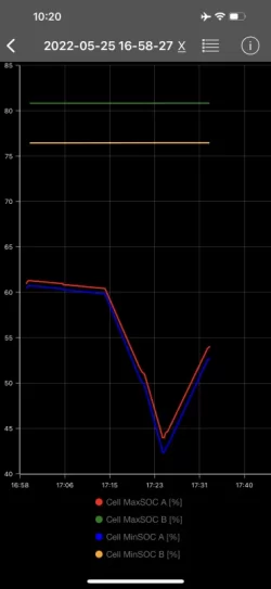

From all the other max/min SOC readings that everyone has posted, I seem to have the largest variation.
The numbers you just posted seem much tighter than what you originally measured.
They range from 3864.4 to 3883.2 That is a 19 mV spread (much better than the 200 mV you found initially).
Perhaps the BMS is working on these new cells and reaching a proper balance.
The new numbers seem almost normal.
You make a good point. I need to be consistent in my measurements. Going forward I will collect open circuit voltage readings after a full charge and also at nominal 3.7v. Then I will compare full charge to full charge and nominal to nominal. By normalizing as such, I should have much more reliable data to analyze over time.
